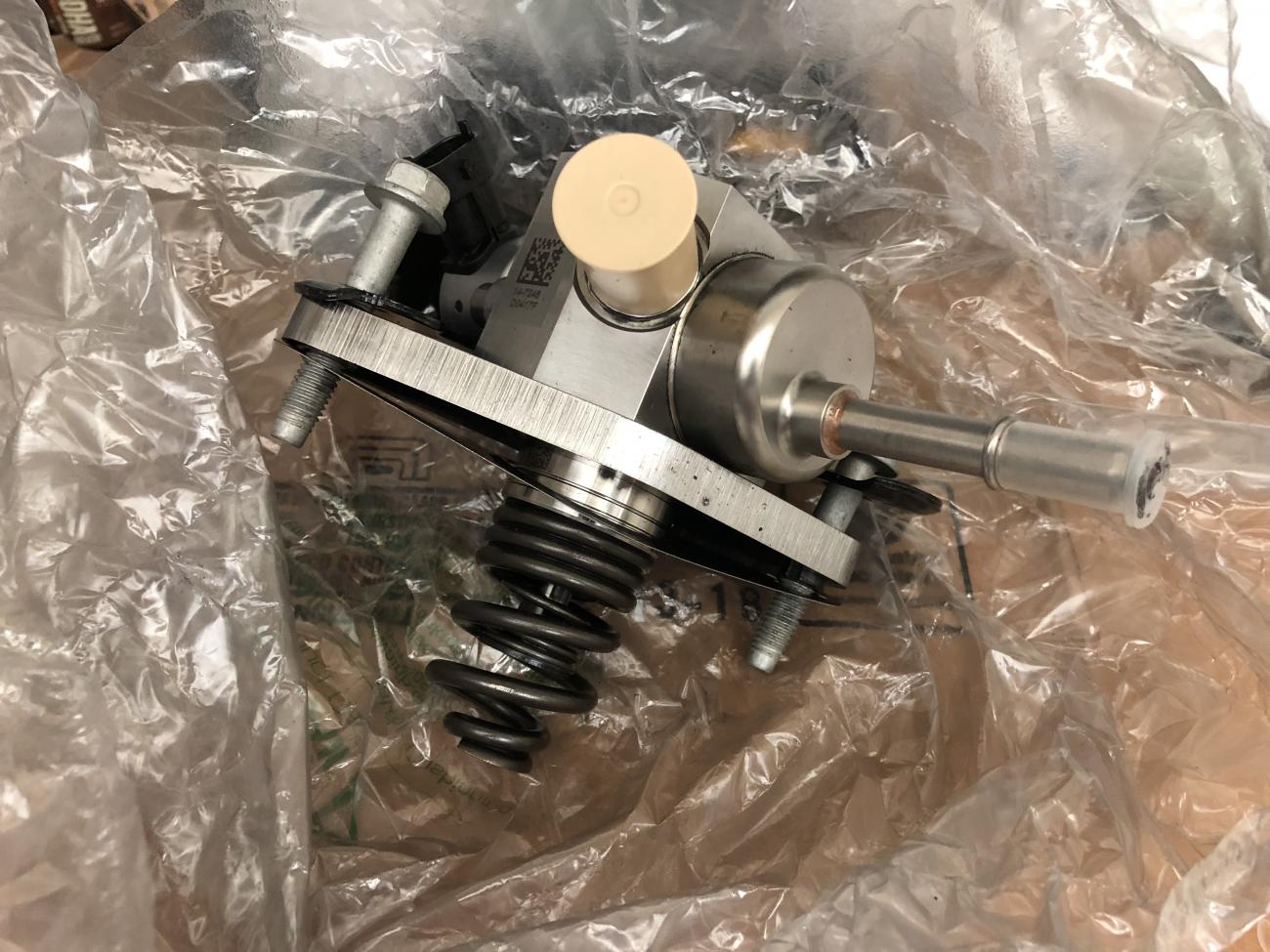

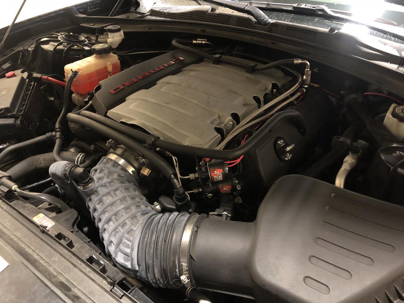

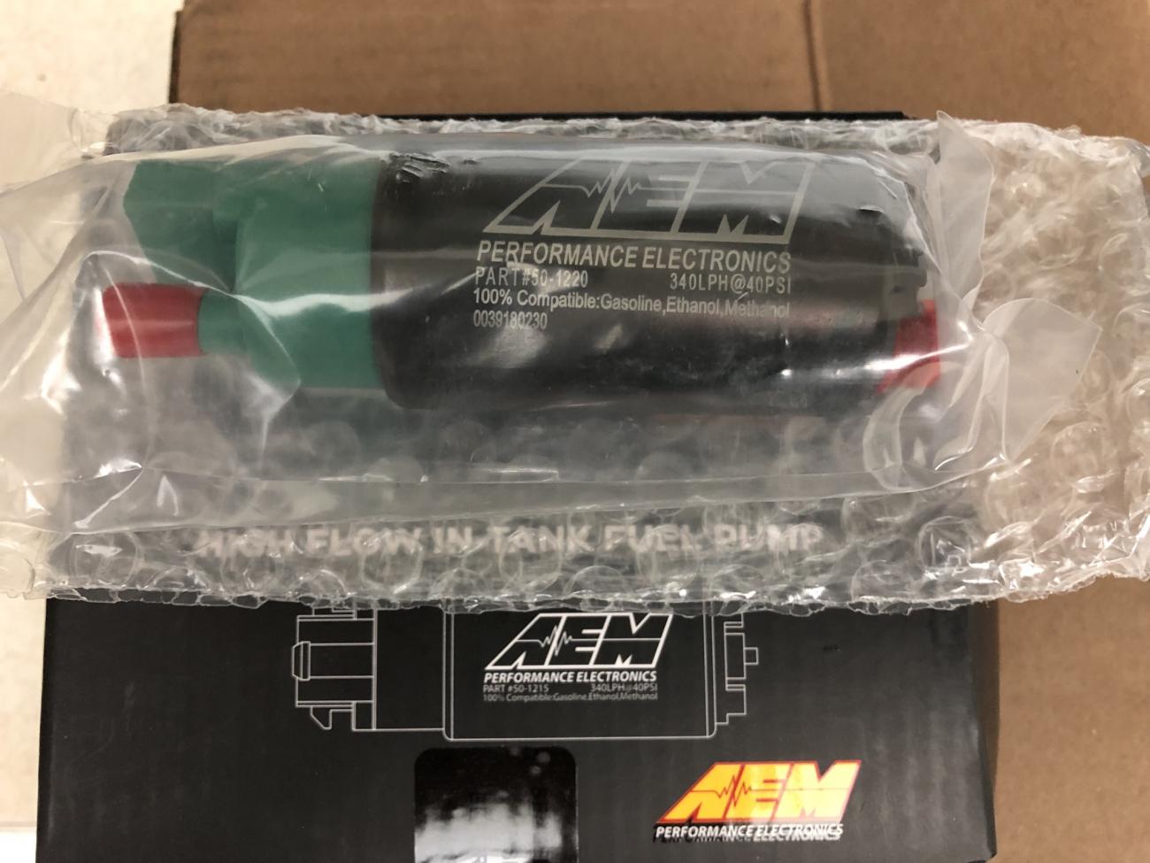

Update
Fuel system made it here. The AEM e85 pump is very compact. I’ll start with the header installation tomorrow.

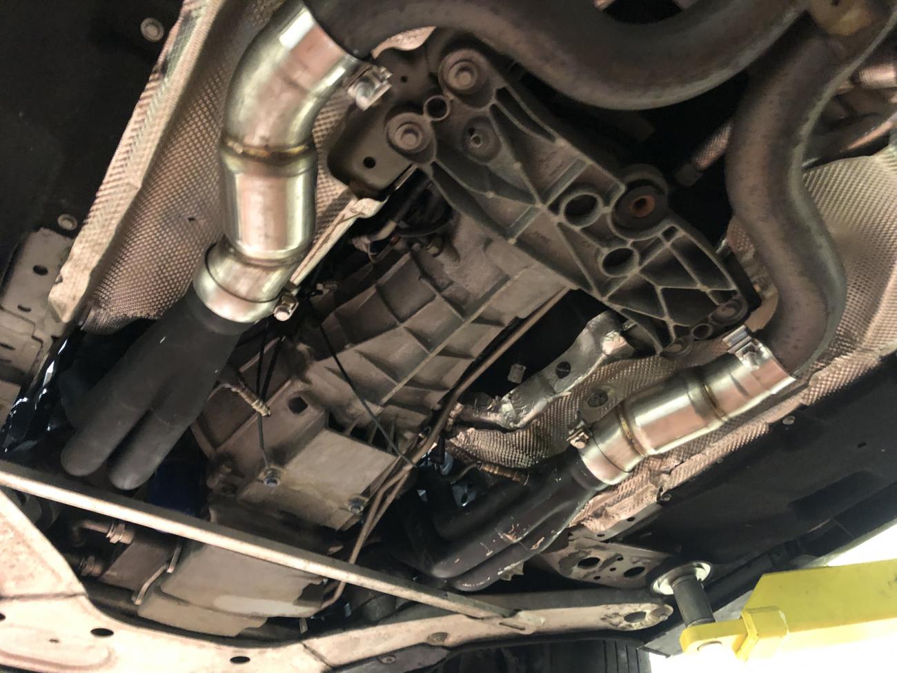

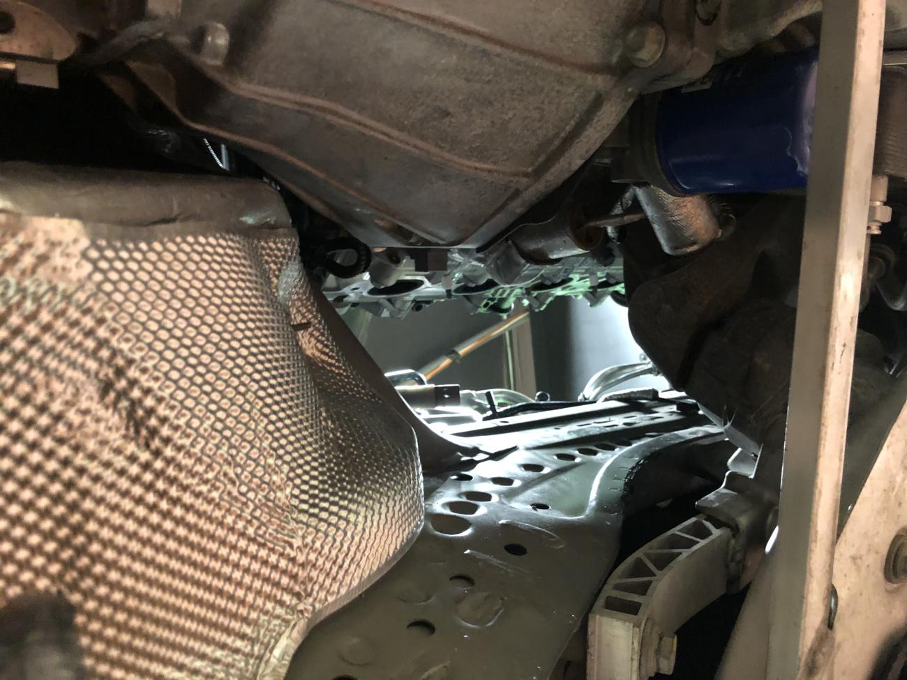

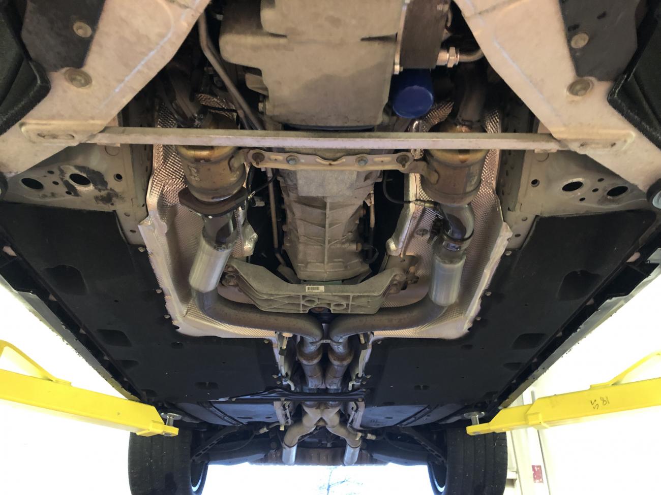

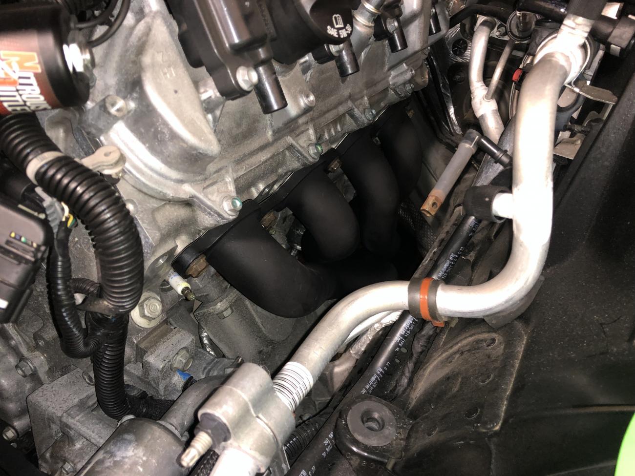

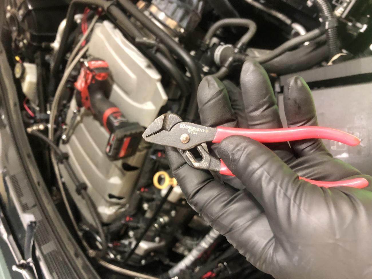

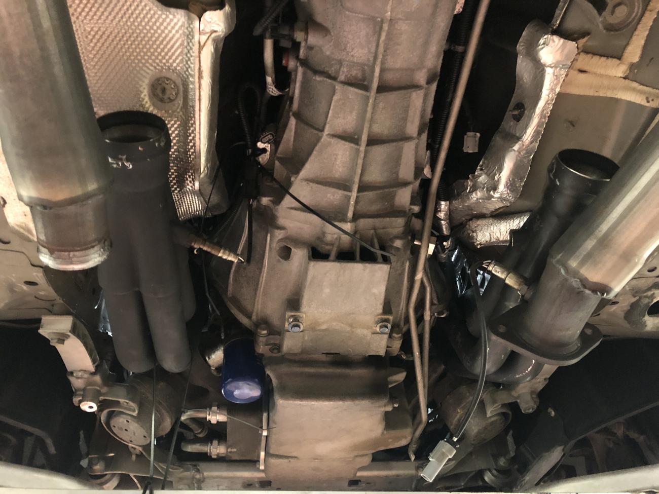

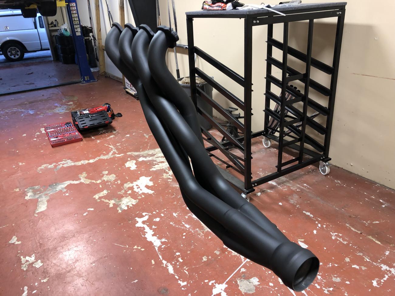

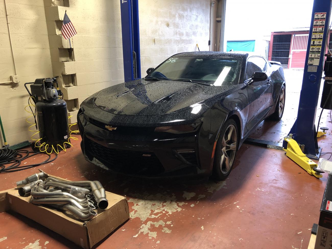

Update:
So I will start by saying the headers on the passenger side are a pain to slide through the bottom. I ended up moving the fuel and brake hardlines temporarily. Only then could I slide them through. I have to touch up the ceramic paint now. The plan was to cure them from the exhaust temperature while running in stages. But shit happens. The first picture is my plug wire boot tool, awesome little Channel locks. Also my plug wire on the passenger side was touching all you need to do is trim the rubber 1/4” does not affect the wire itself.
