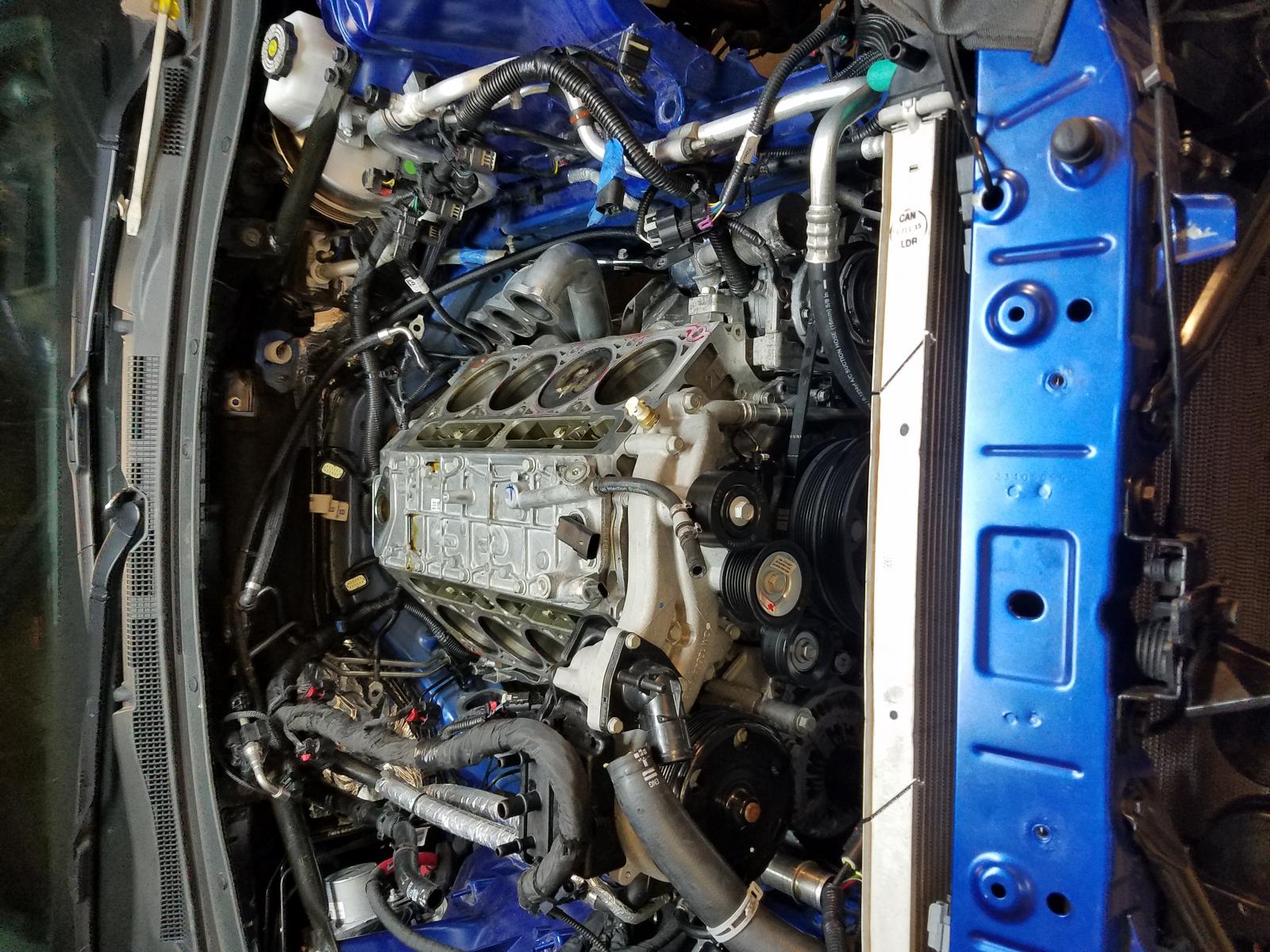

Day 2: blower and heads off. Intake valves look good at 14.6k miles.
Should be able to get the motor out on my next session. Had to knock off around 5 to go to another damn Christmas party lol!

We pulled mine out from the top, guessing that's what your are doing. How much boost are you planning to make?

I'm pulling out the top. Hoping i can drop the cradle a bit, tilt the tranny and get enough clearance to pull the motor forward enough to separate the motor/transmission. From what i gather, it's not particularly easy on an m6 car. I planned to pull the motor today but I'm having second thoughts, I feel like shit - running a fever and about to cough up both of my lungs lol! I'm gonna load up on ibuprofen and reassess in an hour or so.
I'm starting out with an 85mm pulley so i should be making 8 -9 psi. I think this will work well with E70 or so. Still hoping to have enough headroom on fuel to just pull up to an e85 pump and fill 'er up without worrying about mixing.
