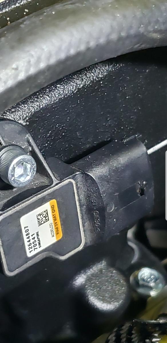

I need a 3 bar map, do I get one for the 2015 ZL1 or the 2017. Of course I want plug and play. Autozone says they are the same, dunno.
If your supercharger has already relocated the IAT sensor where it can read IAT then you can use a standard Gen5 ZL-1 map sensor 12592525
It you want the MAP sensor to read IAT as well the Gen6 ZL-1 sensor is a 4 bar with IAT sensor built in better known as a T-MAP sensor. note this will require an adapter harness to jump the IAT wires to this sensor.
Ted.

Well the map that I got has 4 wires and a lt1 camaro has 3. So what is the application that I need that is plug and play on a camaro LT1?

Here's a pic of the ZL1 Tmap..

Tell you the truth, I don't know what engine and what body styles etc. I just know 3 wires don't plug into 4, the LS9 which comes in a ZR1 Vette supposedly has a 3 wire MAP.
The one that I told you about a month ago plugs right into the LT1 harness. GM 12592525, the red one.

yep must have ordered the one for the LT4 or 6th gen Camaro ZL1 = 4 wire.
Need 2009 ZR1 or LS9 = 3 wire 3 bar MAP (red)
or 2013 Camaro ZL1 or LSA (dunno, I'm old) = 3 wire 3 bar MAP, heck.

Not the case, 1 bar 2 bar 3 bar 4 bar all use 3 wires for MAP data the 4th wire is for the IAT sensor located in the T-MAP like the LT-4 uses.
T-MAP stands for Temperature/Map sensor combo, I had explained this earlier in this thread and recommended you use the 3 bar map sensor from the ZL-1 ZR-1.
