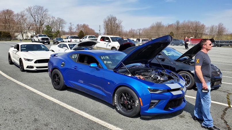

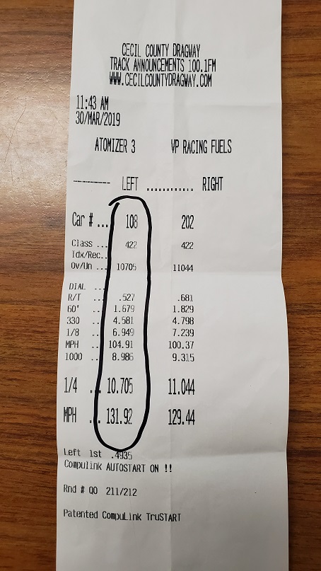

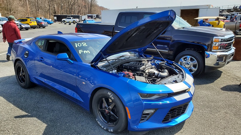

Finally made it to the track this past Saturday 03/30/18. RPM out of Wilmington DE had a late model shootout at Cecil County in MD. My previous PB on street tires was 1.738 60ft, 10.871 @ 128.93.
Since then I have added 2" kooks, RF big gulp & NW103, retuned at CSP which it made 653/618. Also this was the first time out on my drag pack:
Front
Wheels: Race Star 92's 17x4.50 5x120BC 1.75"BS GLOSS BLACK
Tires: M/T ET FRONT 27.5/4.0-17
Rear
Wheels: Race Star 92's 17x10.5 5x120BC 7" BS GLOSS BLACK
Tires: M/T ET STREET R BIAS 28x11.5-17.
This is my first experience on DR's with a manual with this much HP. I was really happy to improve, although I was hoping for better. I need some more practice to get the 60ft down. The MPH is there for a 10.50 pass, just need to cut .1 from that 60ft and I should be there. I was probably the slowest car in the class, and in the final 4 I was taken out by a 9.50 CTSV from RPM with a maggie and NOS. But it was so much fun to be at the track on a beautiful day making passes.
Best Pass to date: 10.705 @ 131.92mph

I think your doing great, I would consider buying a lowering kit and dropping your ride 1.5 inches and I use the phastech kit. My car has always mph'd better then most and I believe its Aero. My car launches just as hard and have had 1.45 60ft as my best so far on the old motor.

Thanks laynlo15! I have looked at the lowering springs on and off, just afraid of tire clearance at this point, already rubbing the driver side rear liner. I don't know if i can get into the 1.4's 60ft with the M6, maybe, maybe not. I had no problems hooking, no clutch slippage, going to keep giving it more and more RPM. Most i gave it this weekend was about 3500.

beautiful car, it looks badass on that drag setup. the hp times and comparison seems odd, though. 417 whp it went 116. 653 whp it went 128. 12 mph gain from almost 250 whp? that is suspect, at best. i’ve seen mid teen cars spray 150 first hand and go 130. just curious, something doesn’t add up.
i’m really struggling with which direction to go, blower or na. i feel like both would trap similar but the blower would be the cheapest and easiest route. lots of 540 whp cam only cars going 130+.

Thanks for the compliments. There might be a mph or 2 in there when I get the 60ft down. But take a look at the Power Adders Stock Displacement fast list on the forum here, the MPH is on par for the ET, and actually you stated 128 mph, it went almost 132 mph, so maybe thats where you dont see things adding up. I really don't see anything suspect about it. There are guys running 10.20' at only 133, then there is a 10.20 @ 139.
On street tires I went 10.87 @ 128 with 620rwhp
On my drag pack I went 10.70 @ 132 with 653rwhp
check out group (5): https://www.camaro6.com/forums/showthread.php?t=427506

Actually he gained 15mph. But the hp gain came with a weight penalty. Have to get the car moving, and that extra weight hurts. So not the same efficiency as it was when NA, or the same as nitrous either.
