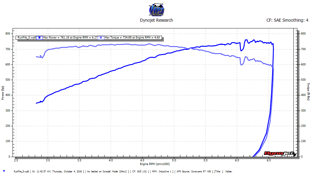

I am starting a new thread for conversation or discussion related to the changes I have made. I figure that a bunch of people are considering their build options so I wanted to lay out what I have done and the results to date.
Let me start by saying Ted Jannetty has been incredible. Every time I sent a log file, he had updated tunes turned around ASAP. I was a little scared about remote tuning because I had a previous experience with another tuner and it was a complete nightmare. With Ted...It could not have gone any smoother!
Ran by the dyno so we could get a good pull. There is probably more in it because right as the car is building max power, it looks like the converter locks or something and timing gets pulled. You can see the dip on the dyno below.
Attachment 959448
Updated Changes to the vert
We started with 8psi for 700whp with the 85mm pulley.
We changed to the 80mm pulley and saw 10psi, but did not go to the dyno (logged on the street)
We then swapped with the 75mm pulley for 12psi.
Where I live the e85 pump is really e70 so testing from 8-12psi has all been at that level.
Next step is to get to the track and get some runs to get everything finalized, but I think based on what we are seeing, we could be the first vert to run in the 9's.
