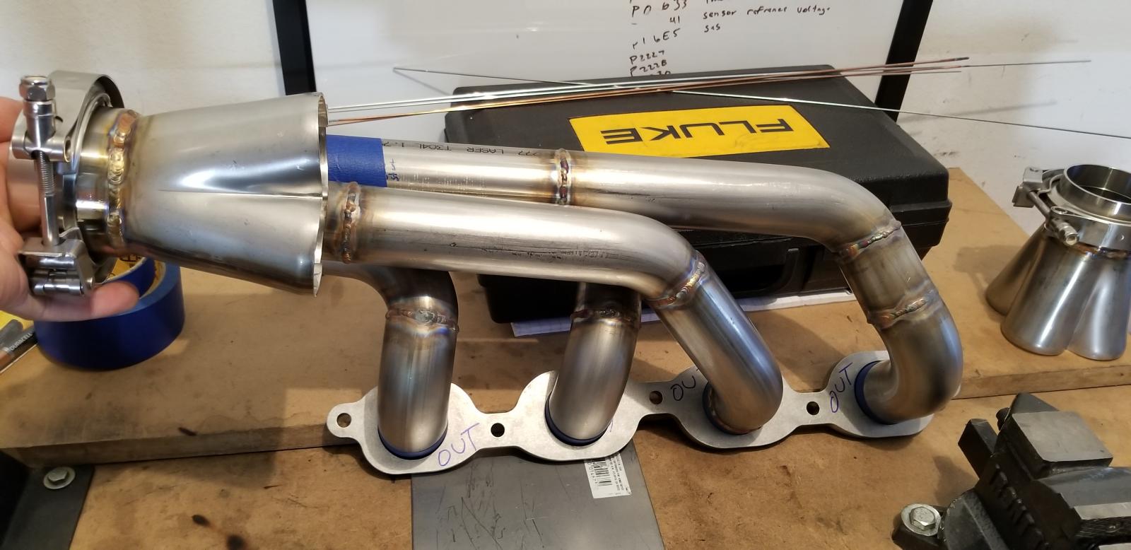

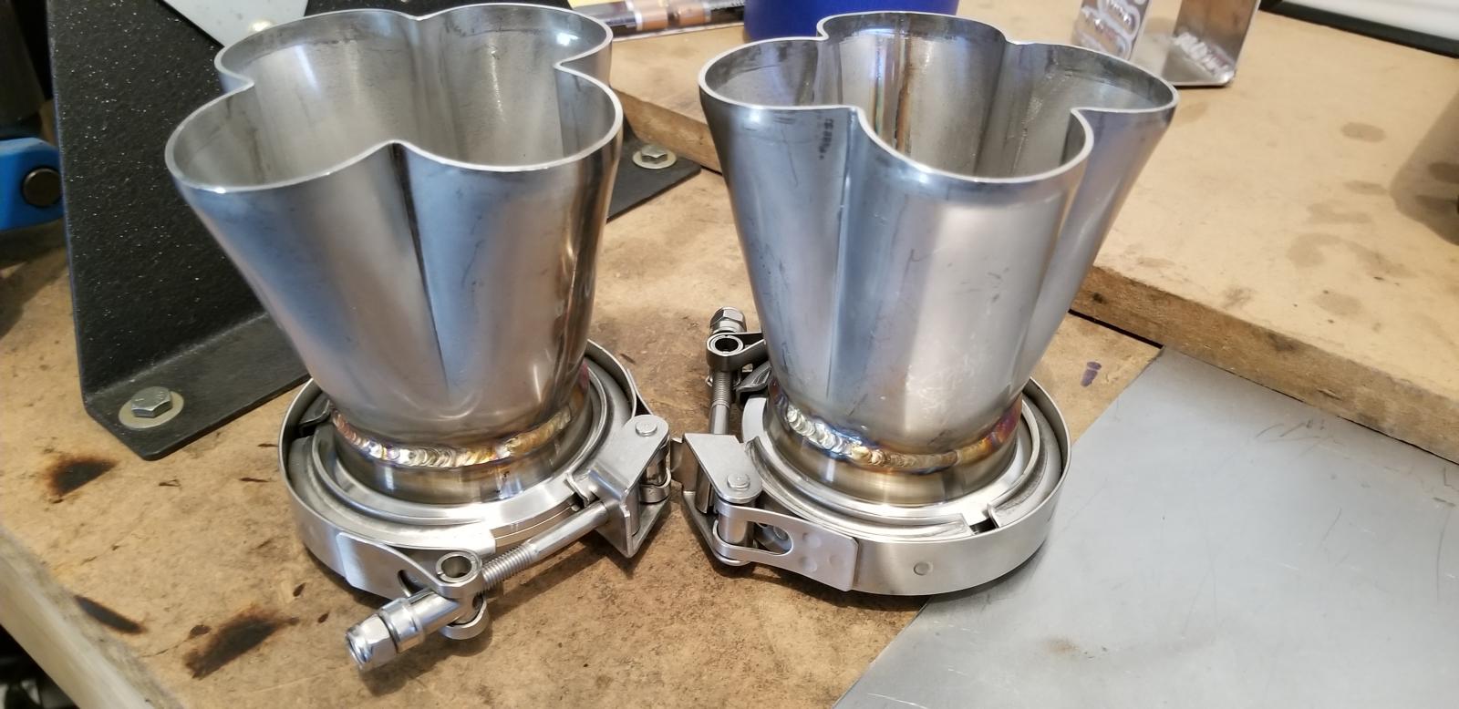

Here are a couple pics. The first is a pic of the Motion Raceworks header build kit. 1.75 inch tubes and 2.5 inch collector. Name:  20180406_162505.jpg

Headers coming along...kinda. But should be finished tomorrow. I really like welding Stainless steel. To me it is much easier than aluminum but aluminum is not bad though.

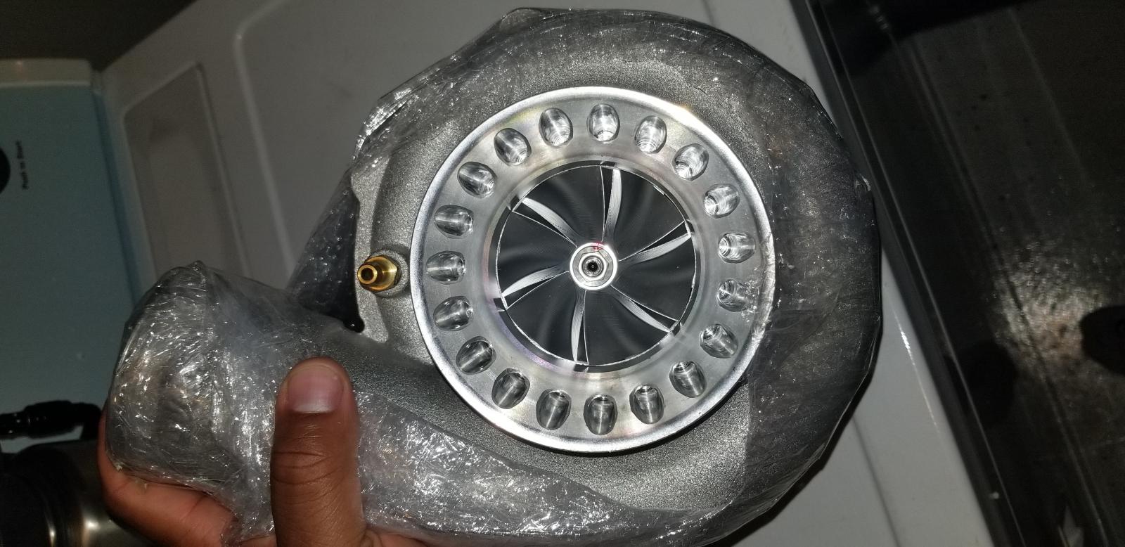

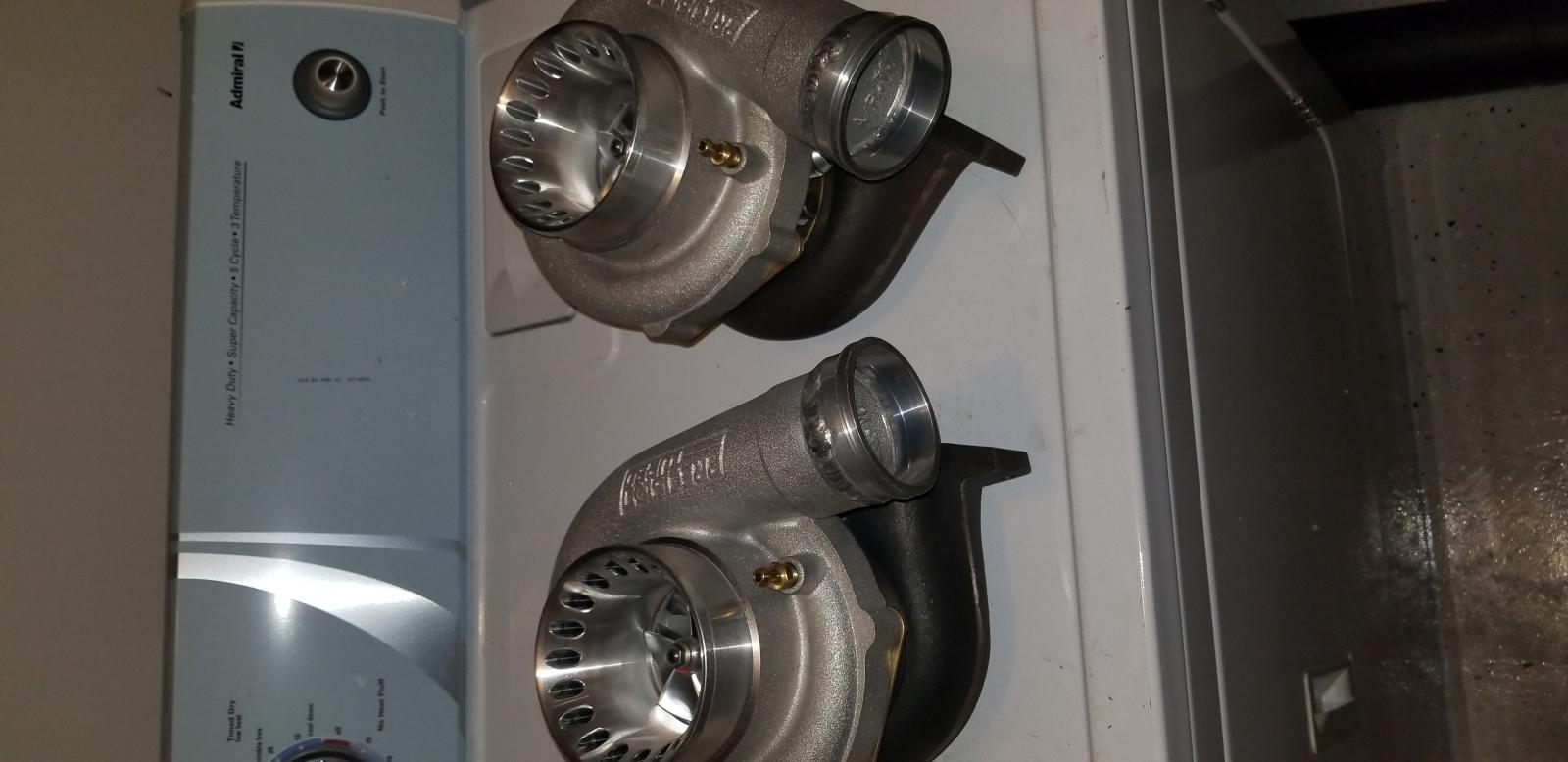

And a couple turbo shots.

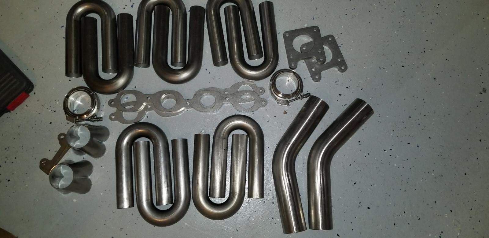

Yeah. I ordered a couple extra bends for the headers just in case. The others are for the wastegate charge and discharge, and turbo charge. Luckily I didn't need them yet. I'll be done with them tomorrow.

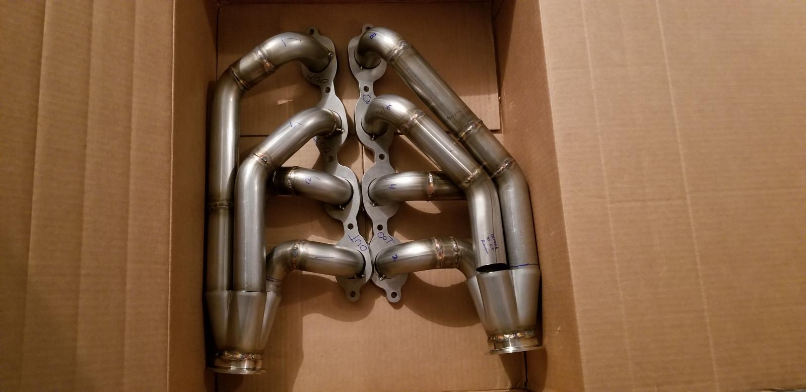

Getting close. Just ran out of argon. Back purging is a bottle killer. But I was able to get measurements to make my input pipes and the rest of the hot side!

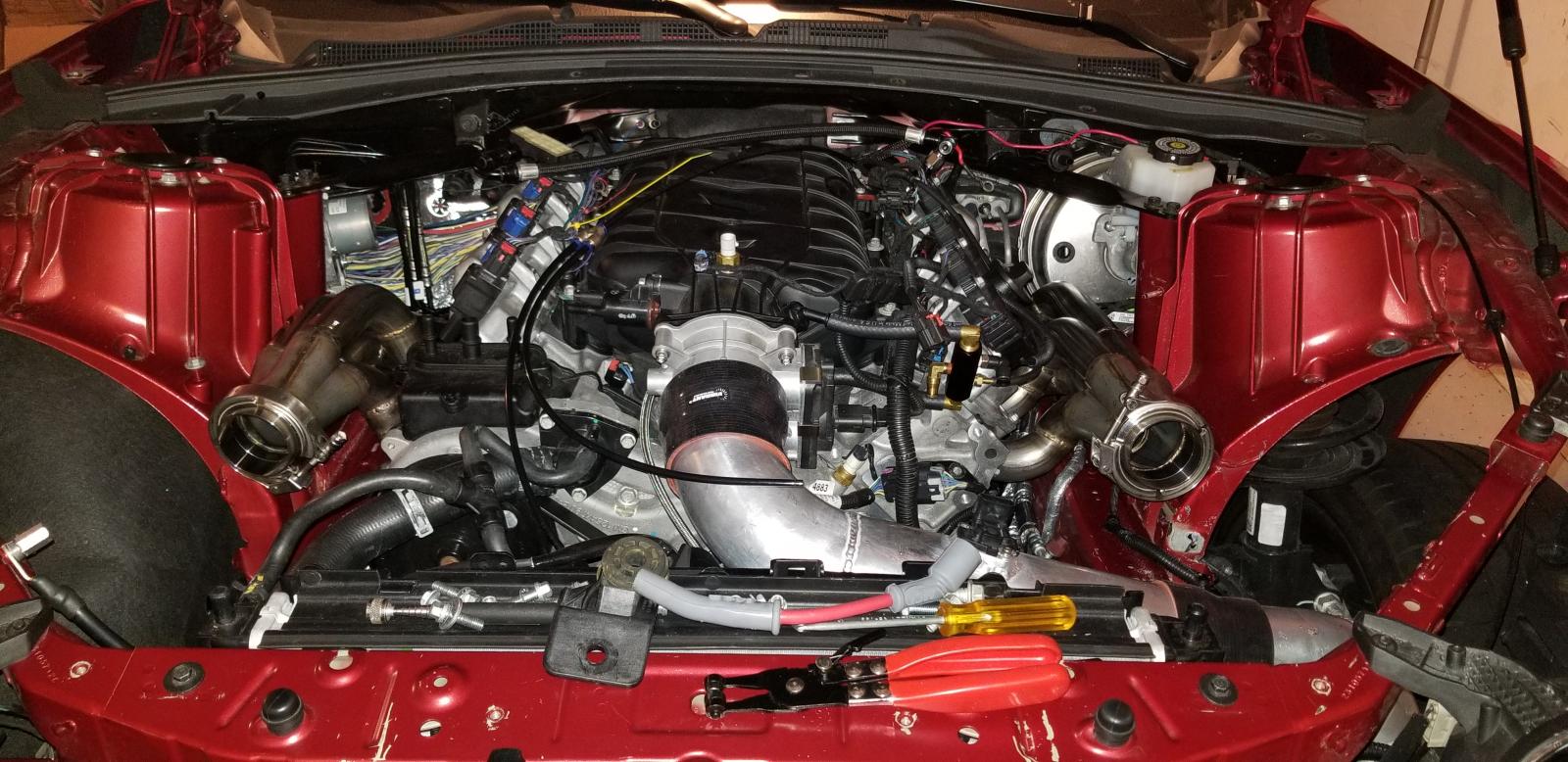

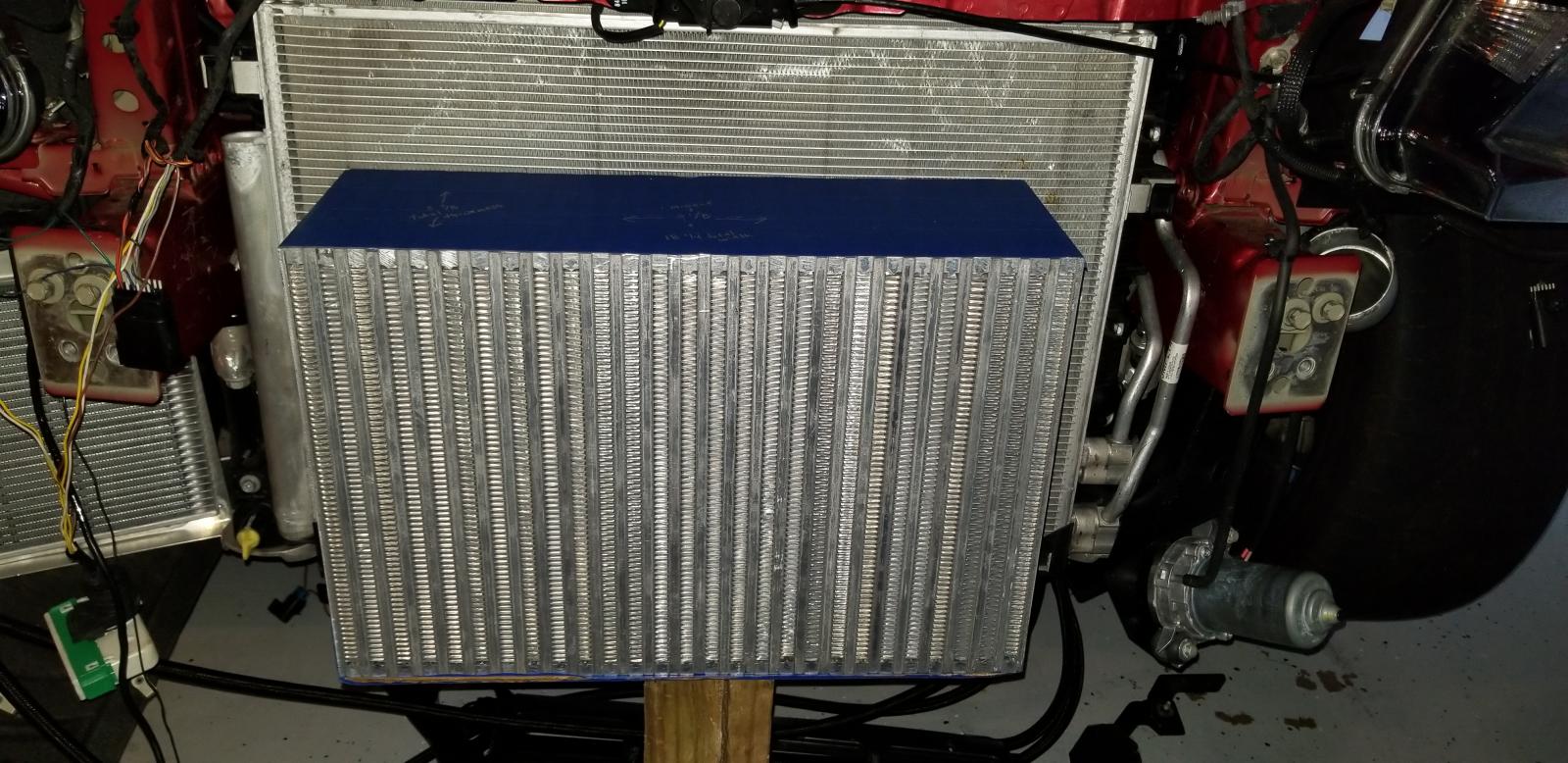

Started fitting the intercooler. This big beast takes up a lot of room. 18x14x6 she gonna flow.

Glad to see a FMIC being installed. I've always though the 6th gen ZL1 front bumper was just an invitation for just such a design!
Looking forward to the results.

Thanks, but this is just a lowly old SS. But I like the front mount stuff may do air to water if air to air doesn't work out as I'd like.

Headers fit nice... now on to turbo mounts.
