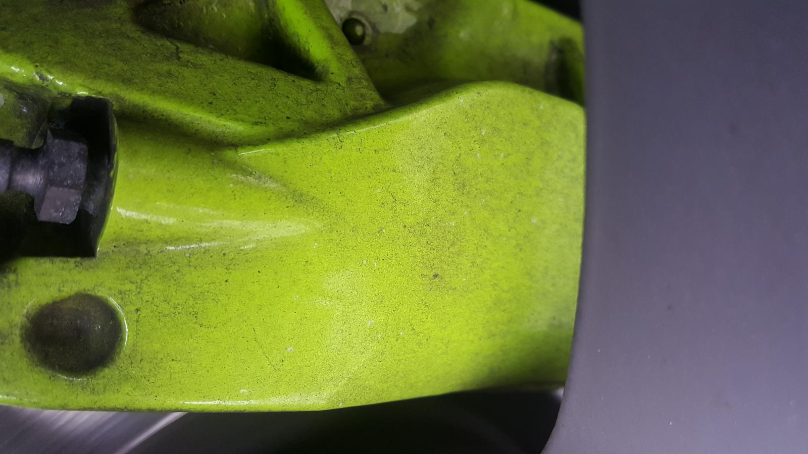

With the G2 doesn't it come out looking like it was brushed on? That's what it looks like in the pics.
Nope. Dont have any at all.
Prob put about 20k on em, and they are dirty. Its snow season here and its gonna rain in 2 hours... and truthfully generally i dont was my car nearly as most on here. but heres a close up..
Thats why i mentioned as the paint cures it tightens up.
