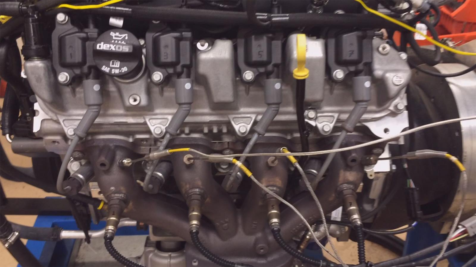

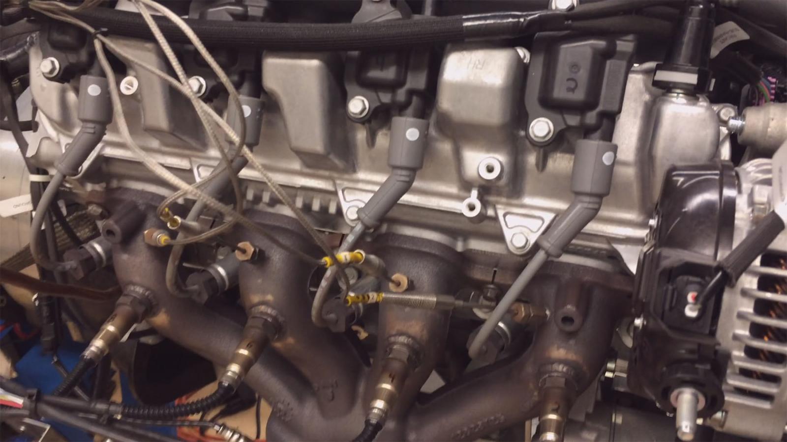

I certainty don't get to play in the shop as often as I'd like - but when I do, I have a fully instrumented LT1 to work with and am more than happy to have the ability to make informed posts which include results from real data.

That does not look like a current, direct injected Camaro LT1 engine, it does not have the 3Y headers.

Its currently in C7 LT1 configuration (exhaust, waterpump, crank pulley, MAF and air filter) as that's what we're working on right now, we can swap it to Camaro in about an hour.

Are those EGT sensors along with O2 sensors on that engine? Are they Wideband O2's? would love to hear more about that system.

Yes, 8 channel Wide Band, Exhaust Gas Temp, and 8 channel inlet port temp (which can't been seen in those photos). With the 11.5 CR and fuel pump limitations on the LT1s good instrumentation is really helpful to find the best balance between boost, timing (cam/ignition) and A/F ratio.
