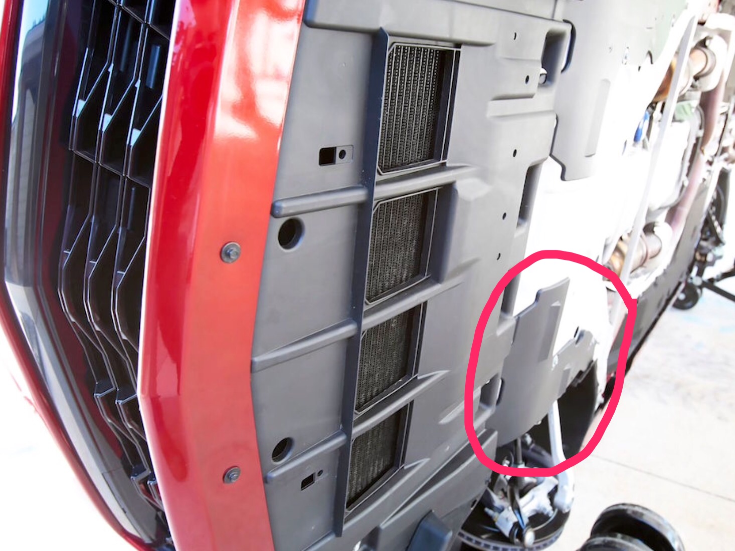

Originally Posted by Adrian97c View Post
Could you record your rattle? Is it only on cold starts?
Adrian, since getting my car back from this recall, I have this light rattle on the front driver side, its faint but you can hear it as you start to accelerate lightly, almost like a rapid tick or even a loose screw, also I will add I have had a problem with the front driver side caliper seizing since the recall. Looking under the front of the car you can also see when they reinstalled the plastic cover near the bottom driver side wheel it is not sitting flush like the other side, so that needs to be corrected as well. I will be ordering ramps soon and take care of all this my self, I have had enough of the incompetent dealerships screwing up my vehicles. So that being said once I do get under the car if I find out what it is I will post for sure.
Thank you! Post pics of what you described also.. the plastic thing?, so I can check mine. how can you tell if caliper is seizing?
When I was on the Hwy and had to apply the brakes hard , the car pulled to the right very hard and did not have proper stopping power at all, when I got off the Hwy I could clearly see the brakes were not working on the front driver side because the rotor was not even touched by the brake pads, I got it to work after slamming on my brakes on a side road. I will try to get a pic of the plastic panel for you.

This plastic cover is not sitting flush
