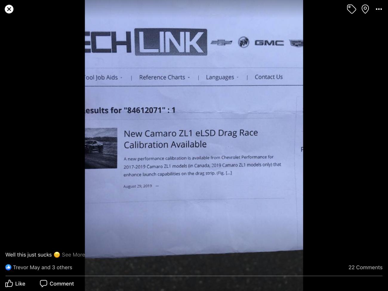

Originally Posted by meSSohappy View Post
Yes..cool...followed all of your advice last year at the track. was able to get a rythym going for the factory line lock as well. I like it...much better than using the brakes.
Anyone know if the 18s came with this updated eLSD? My dealer doesn't know anything.
Well now I’m pissed and frustrated. This calibration is only available to American cars...NOT CANADIAN ZL1s. It can be done to the 2019s but the 17s and 18s are SOL...WTF GM.
The USA cars have different programming and this upgrade is VIN applicable. Even if I took my car south, I couldn’t get it done.
Somebody please explain this! What or why are the USA and CAD cars sooo different?!

Old 09-07-2019, 11:32 AM   #145
Posts: 38,040
I'm pissed we actually have to pay for this one.
Seems more like a fix than a mod. This was my biggest issues on the 17 I had.

It's annoying they sell this and you have to go in for it to be flashed. More manufacturers need to get on the modern train and start doing OTA updates like Tesla. As they make software improvements, just let our cars download them. its freaking 2019. Imagine if you had to bring your phone, laptop or any device into the dealer each time you had to update it.

I totally agree. Even if it's something that you had to pay for, it's not that hard to setup a store to make that purchase electronically. I would bet they would sell more of these updates/enhancements that way.

So im having the eLSD calibration installed at the moment and Chevy is quoting me $415.00...$280 for the technology and an hours worth of labor. Anyone else have this same experience? Slightly different than the $350 i read about..
