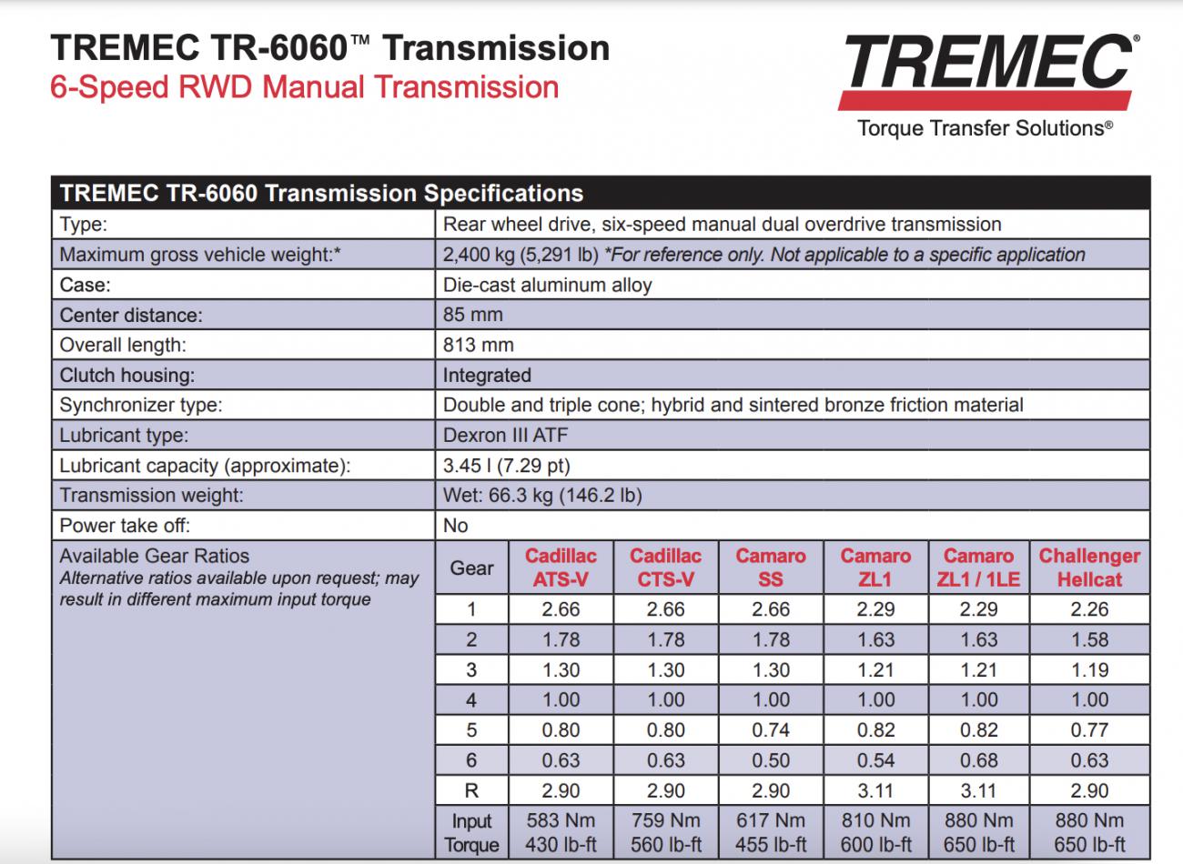

Originally Posted by JBones81 View Post
what about with the manuals? I don't plan to get nuts with this car, but then again I havent planned that with any previous cars but they always end up seeing tons of mods LOL
It makes you wonder if this is the reason for all that torque management, especially on the ZL1 with the M6.
https://www.tremec.com/anexos/Litera...et_TR-6060.pdf
Attachment 1105203
I read somewhere on the forum that stock twin disc clutch and Tremec TR6060 can hold up to 1000 crank hp or 800+ wheel. But your brochure states much lower numbers. Hmm…
No idea. I bet it can but the published figures may be more conservative. I assume GM dials in a bunch of torque management to prevent warranty claims as well.
