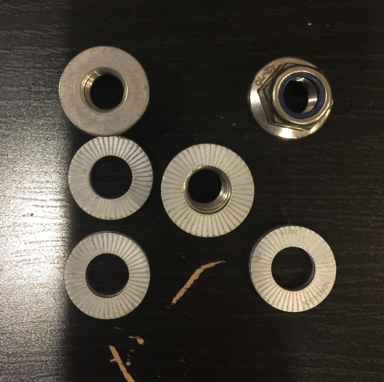

So instead of dealing with these sleazy service departments around here I figured I’d go the NordLock route myself. Ordered the BMR endlinks because of the more robust design along with nylock flanged nuts. Important to note there are two sizes of the nordlock washers and if you’re using the oem nut or another flanged nut you should order the larger OD size. Here’s a comparison.

Posts: 104
Well I tried flanged, non flanged with nordlocks, red loctite and the clunk keeps coming back. Honestly I think as long as I drive on crap northeast roads this noise is just going to keep coming back. After the flanged nut I used the smaller conical nuts provided with the bmr endlinks. You can see the nordlock washers were working as they dig into the shock but just don’t hold the endlink tight enough to keep it from sliding around and clunking.
