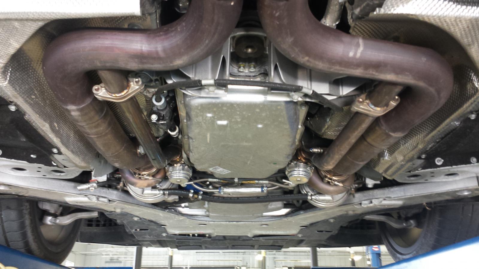

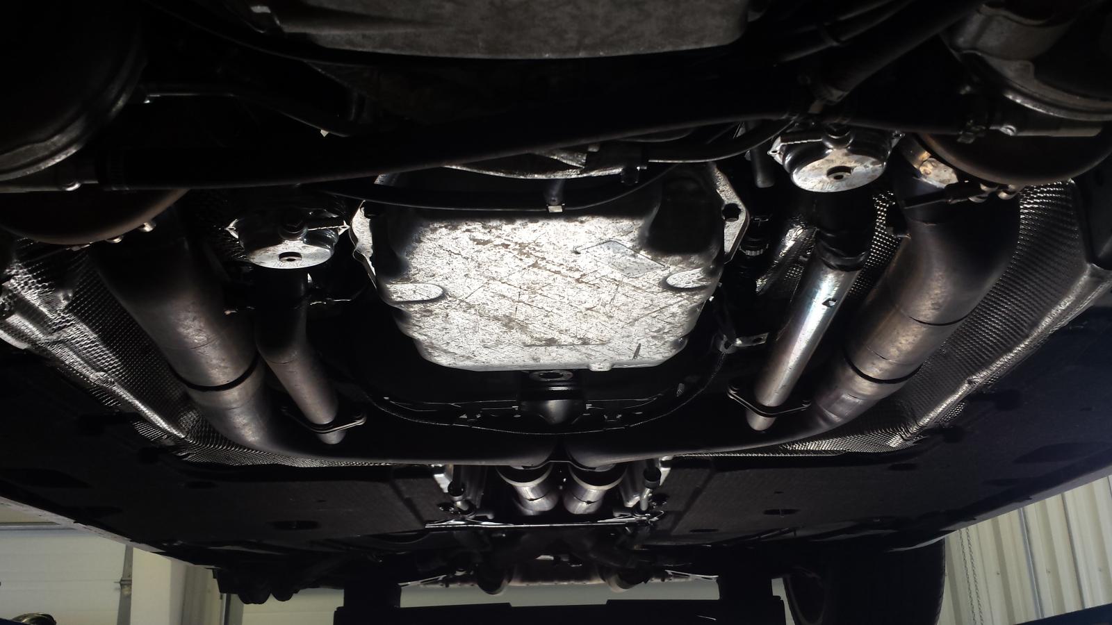

Do you have or can you share some pics from underneath I am sure AGP did an amazing job as usual.

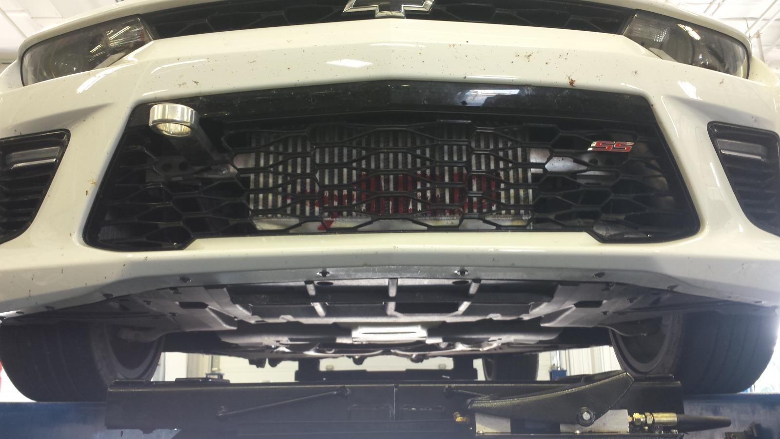

Got a flat on the rear so had to get it on a lift.
The passenger turbo housing hangs down just a little below the front suspension, driver side and plumbing are all above. Wastegates are plumbed back into the exhaust.
Intercooler is reinforced with 3/4" think aluminum tabs on the side that replace the front crash bar and allow tow hook placement. It has all 4 cats deleted, I wish I would have weighed it before and after but think the net weight is almost exactly the same.
Fresh air is drawn from the top. We have had flash floods this year and I had to ford about 14" of water one day to get home... car had no problems. Just went over 6000 miles, still running strong.

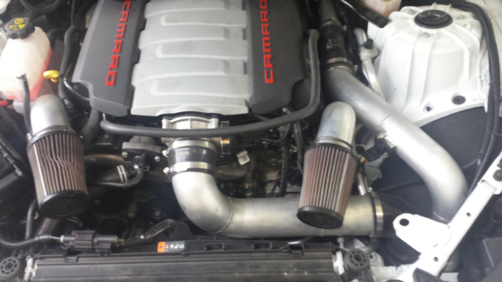

Looks Great but the really surprising thing to me is the MAF location Pre intercooler?
Can you elaborate?

My thoughts^^ also it look like a small pipe it is mounted on. You'll have the maf maxed out with much more power

Good eye. I must admit I have wondered about this also but the car is tuned to run pretty good with it in there. I didn't design the system and don't know if there are any plans to change this on future kits.
I'm curious what kind of power limits you think I'll hit with it the way it is. I'm pretty sure those turbos can drive a lot more air through the pipe but if the sensor can't read the changes then it is kind of pointless.

Note this is not meant to do anything other than educate and add to the discussion.
Any time you install a MAF in a smaller pipe you must scale back the MAF calibration which then in turn reports Less Torque to both the ECM and TCM.
When you put the MAF in a smaller pipe it will climb higher in the MAF Range than normal so you could theoretically run out of MAF range earlier in your quest for power, fortunately the MAF has a range of 1300 HP in a normal size pipe so even if you reduce the pipe by say 25% you still have 900 + HP range.
It also changes the Load or Grams per cylinder which is what the timing map uses for to determine air load which selects timing value vs RPM.
The ECM is not a big deal, there are work arounds for this.
My concern is in auto cars, the TCM will adjust line pressure based on reported torque.
It should not be a problem going smaller but it is a big problem going bigger, we have seen many transmission failures due to a Mammoth intake pipe.
You may notice the trans shifts harder than normal with the smaller pipe.

Good stuff Ted! I got more information on the MAF location. It has to be before the intercooler because this system has meth injection directly into the intercooler and there should not be any Methanol on the MAF. If you are thinking this location should be able to handle 900whp that should cover anything I ever do with this car.
Interesting on the automatic transmission. I only drove the car about 200 miles before turbo install and this my first go round with the 8A so I really don't feel qualified to make a before and after analysis but the shifts are very crisp the way it is set up now.

I am curious where your blow off valve is in relation to the MAF.
A MAF should always be After any blow off valves.
Or when it is open the maf is seeing air flow that is not entering the engine and fueling will follow making a very rich condition.
