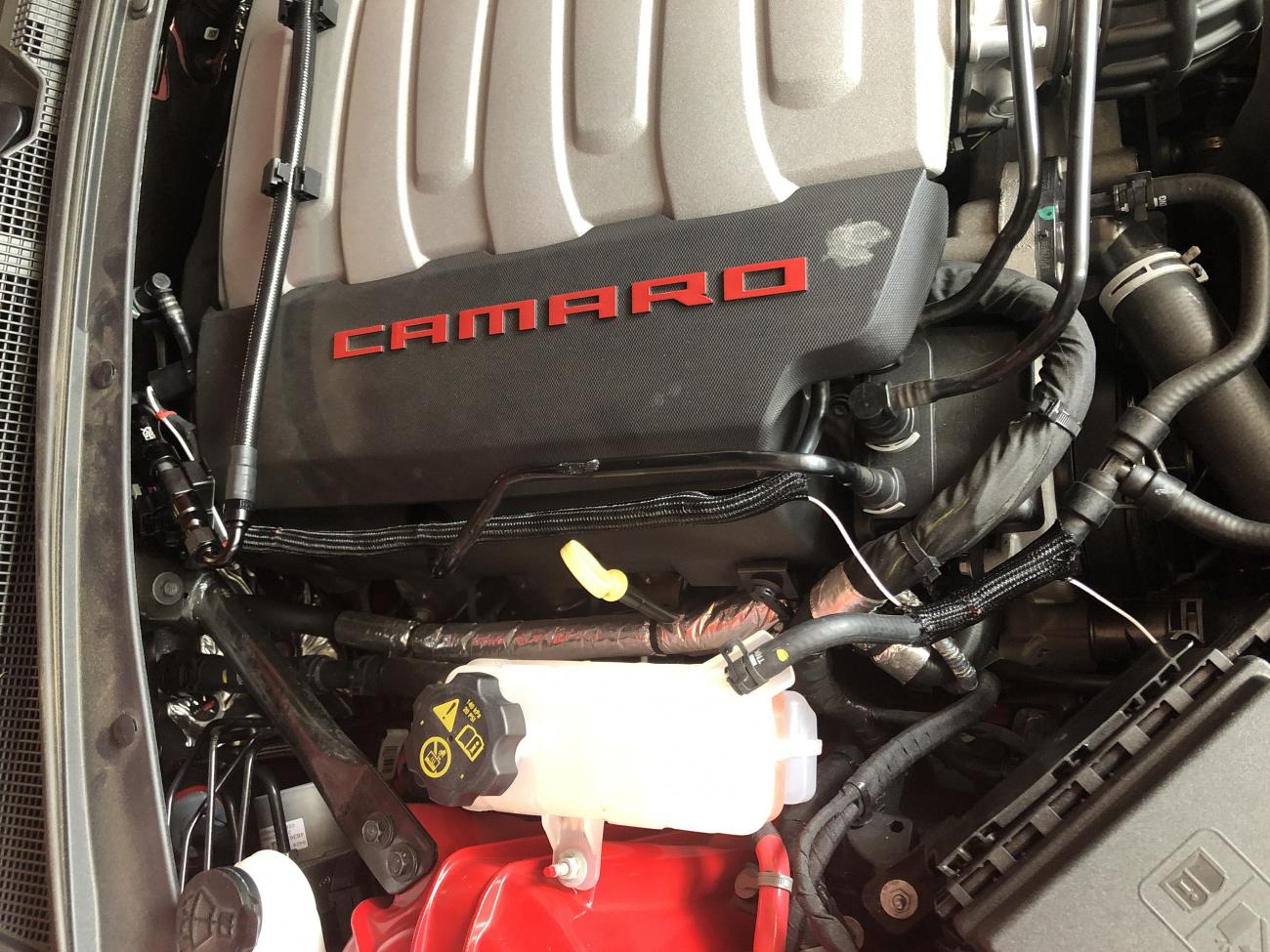

Photo with wire wrap
Thanks for the write up! Just installed mine. Only differences were that my instructions from DSX said the retaining clips were not reused. Also, the wire on mine was white and stuck out like a sore thumb so I used some wire wrap to make it a little more stealthy. I’m getting a custom tune after my rotofab comes in and should be good to go!

maybe its just the pic but your top overflow bottle is supposed to be full to the top.
