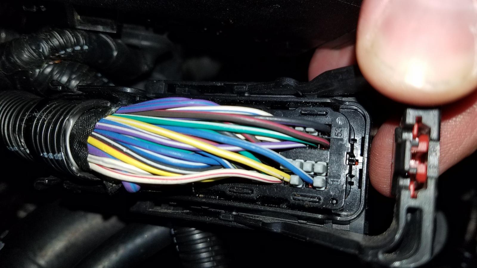

on my 17 there are more wires. it goes brown/red, green/white, purple/white, blue, white, then 38pin then blue.
Where did you get that picture?

the pic is my 17 J1
