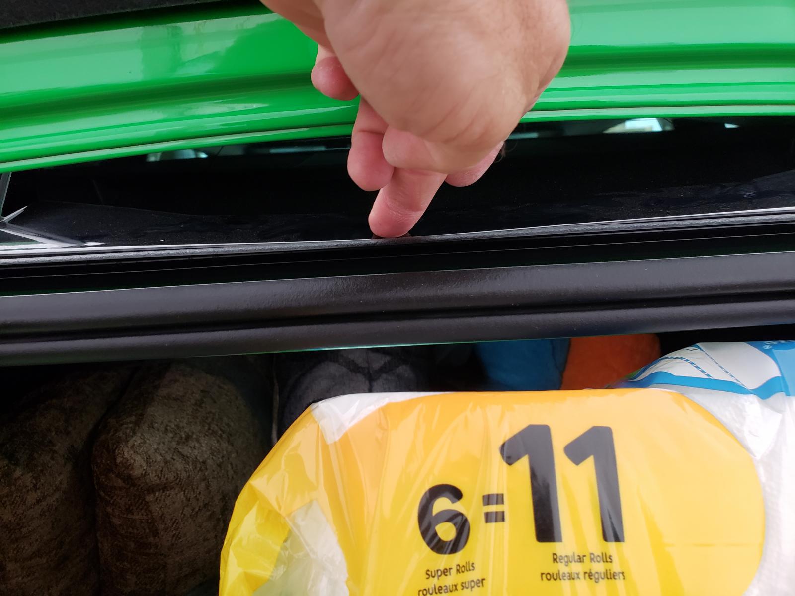

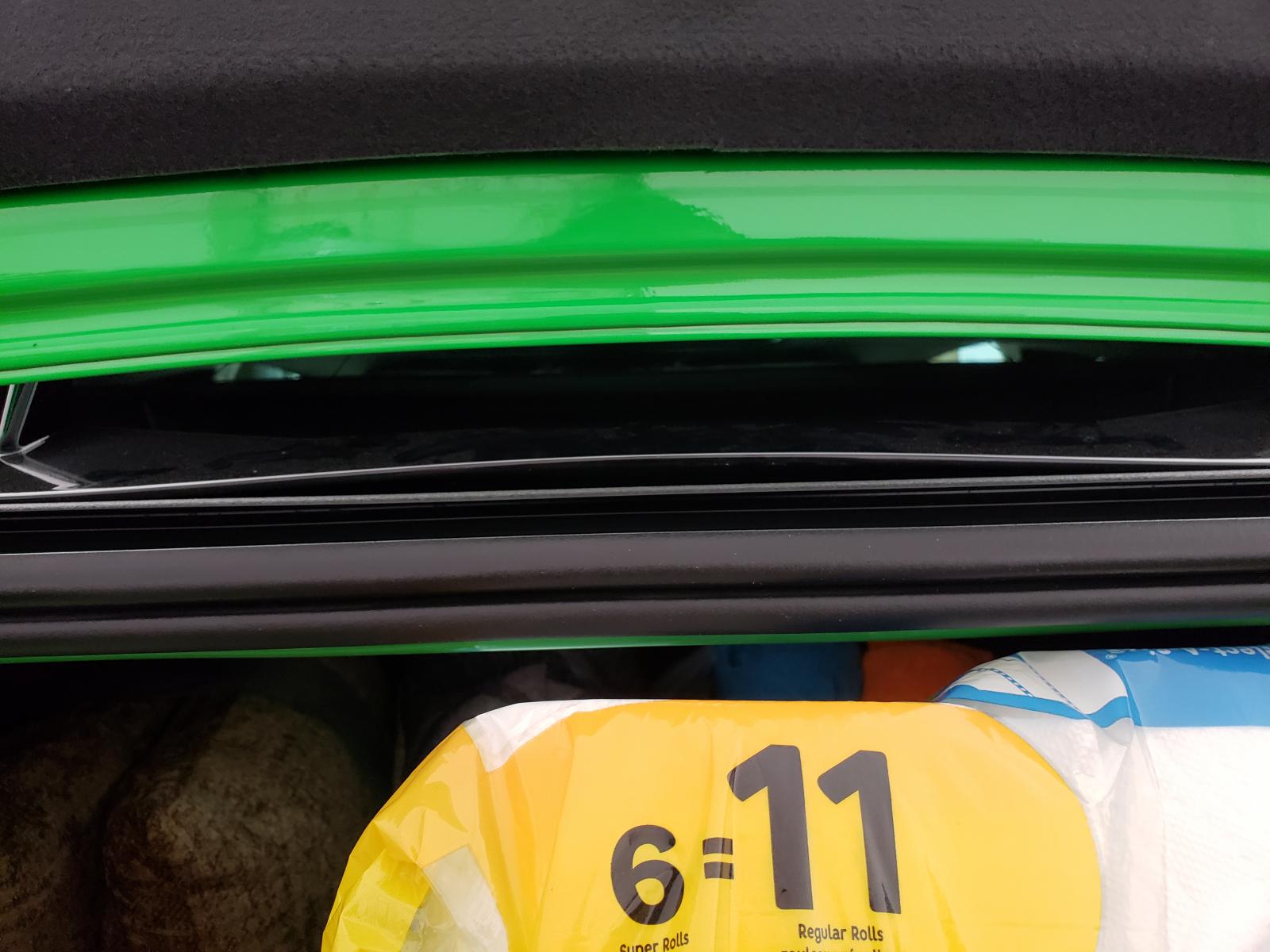

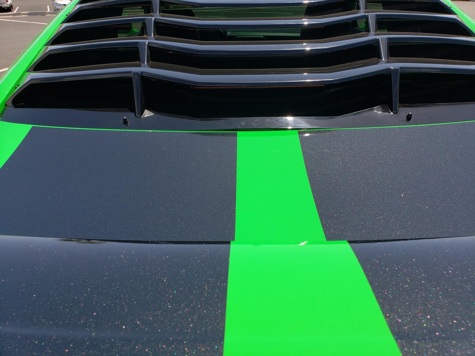

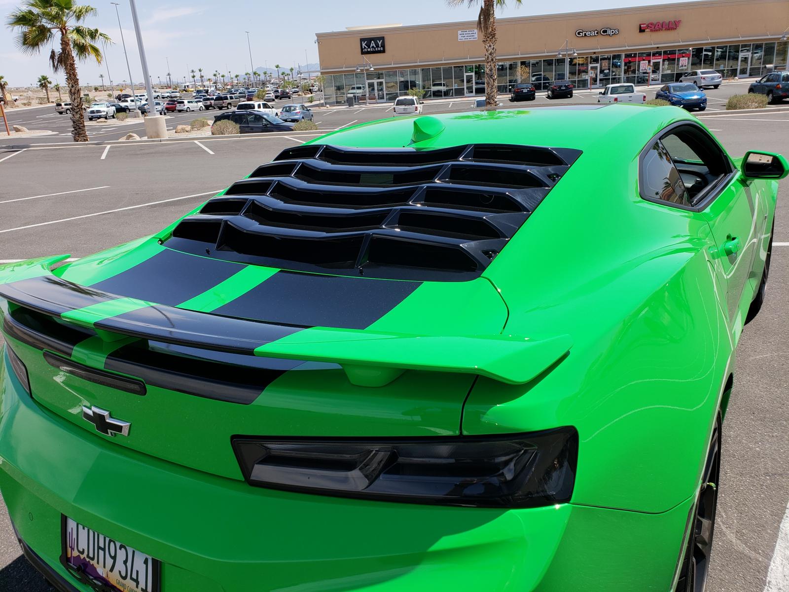

I got mine, and it had a few mis cuts as well, but nothing too terrible. Had it painted gloss black and installed it, which was super easy. I went to the grocery store today, came out and opened the trunk to put my groceries away, only to have my trunk catch my louvers. Wth, j thought this was an Ikon issue. Come to find out, my car sat in 100 degrees for a couple hours and then warped. Along the bottom of the louvers has raised almost an inch and a half. Kind of bummed, but I think an easy solution, is to contact aa and ask for another stud to place where it is warped, and I highly suggest whoever buys one in a hot climate to do the same. Another thing I may do to make removals little easier( it likes to get stuck on the studs) is widen the mounting holes ever so slightly and use black washers. Between these two, it should make this kit look a good as it should.

Damn, I might add some double side tape there to keep that from happening after I get them painted. Just going to make it a PITA to remove when I need to clean the windows.

Aa came through and sent me a couple extra brackets. All I had to do is cut one bracket down, almost in half, line up and drill another hole and voila, no more warped bottom piece. Also, opened up all of the holes ever so slightly, which makes removal much easier, and the nuts still covered the holes, so no washers needed. Also, still tons of clearance between the center just and opening the trunk.
