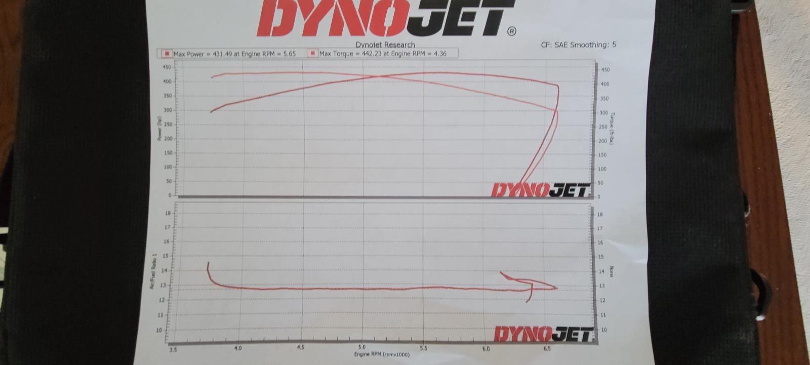

Just finished mine and was on the dyno yesterday. Here is where we finished up on E57. We are still on winter blend here in Missouri and I also had 1/4 tank of 93 in when I added the E70. Made 431/442, we were a little on the rich side but with the combo I have we were stuck, tried leaning and lost power, tried riching it up and lost power, added more timing and it didn't like it on the low E57. My C7 made more power but we were on E70 when we first tuned it back in 2020. We made 8 pulls and started at 429 and ended up at 431 so our initial tune was pretty darn good from the beginning.
