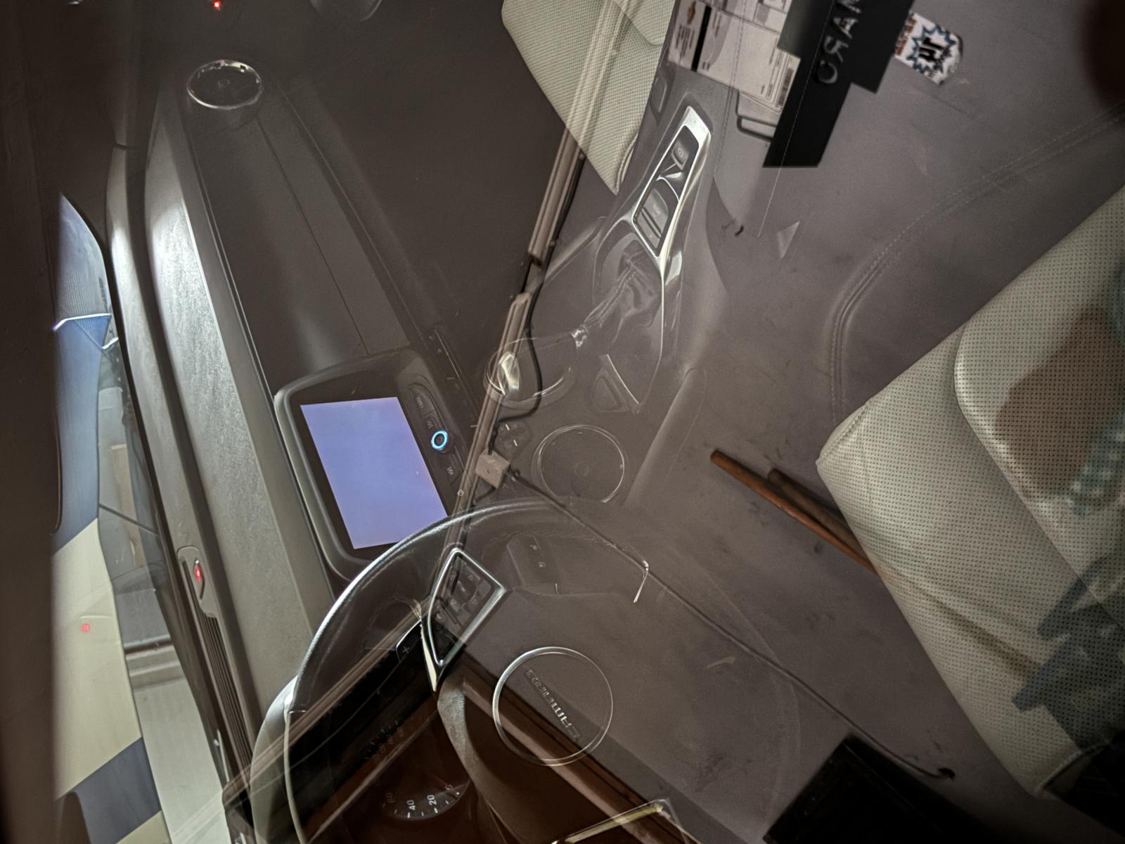

Hi. I have a 2017 Camaro. Last fall the battery started to discharge more and more often when it was stationary for a while. When I tried to charge the battery from the engine compartment, it just said error on the charger. I bought a new battery and installed it. But the next day the battery was dead. I tried to connect the charger in the engine compartment but the charger just keeps turning on. If I disconnect the battery connectors, charging directly on the battery works. Does anyone know what could be wrong.

The screen does not turn off when I lock the car. I also hear a hissing sound when the car is locked. The sound stops when I disconnect the negative terminal.

What charger are you using that it says "error" and what 2 spots in the engine bay are you connecting to
If the screen is staying on, thats probably the source of your battery drain. After you have checked all the above items(and they are fine) then pull the fuse to the screen and see if the battery drain stops. If it does, then you know the problem is with the screen. If it doesnt, then you will have to keep searching
I pulled fuse F55 in the fuse box in the trunk and the screen went completely black. I'll see tomorrow if there's any power left in the battery.
