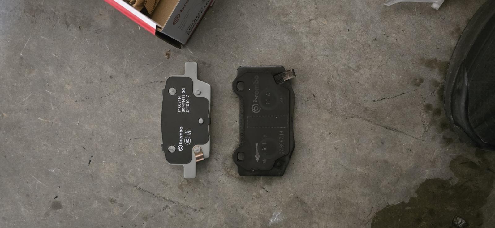

I am going to say that my front ceramic brembo, were perfect and they fit perfect.
I COULD NOT find a single Brembo ceramic rear brake pad. AT ALL. Even Brembo when you place your Camaro SS in the car filter shows a SINGLE PISTON brake pad.... there are no single piston Camaro SS!
I ended up finding a pair of ceramic pads from Napa yesterday.
https://www.napaonline.com/en/p/ADOAD8943
the only issue, is that the inner with the indicator on it does not fit on the inner. I had to put the outer on the inner and inner on the outer. I find it odd because the indicator is not on the inside for the stock brake pads. Thankfully it did not have a directional arrow, the stock pads do.
I cannot for the life of me, understand why there are SO FEW ceramic options for the rear.
EDIT: TO be perfectly clear, Brembo P10071N is a single piston pad!!!!
I attached a photo you can see the comparison to the original!

If you are putting on NAPA pads you might as well go z26 in the rear. amazon will have the best price.
Stock pads are semi-metallic, which is why they generate the orange-brown dust which sticks to the wheels.
Full ceramic avoids this.
