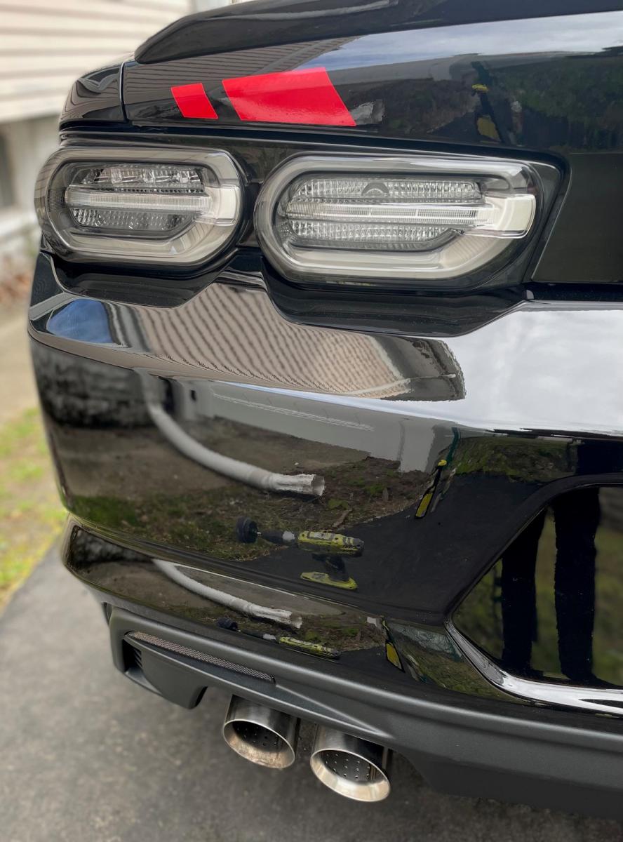

So as much as I like most aspects of the redline edition, the red on the front bumper was too much for me. Part of the reason I like the LT1 is because it's a bit more minimalist, a little more subtle. Like my grandma would always say "when in doubt, black it out". Ok I don't think she ever said that but you get the idea. I did my first oil change @ 567 miles and you know I just had to remove the front bumper while it was up on ramps
So we've got the OEM gloss black inserts for the lower grill P/N 84033928,
HERO Smoked Rear Reflectors, HERO LED Tinted Side markers, and Gloss Black RS Emblem Inserts (I will post some better pictures after a wash).

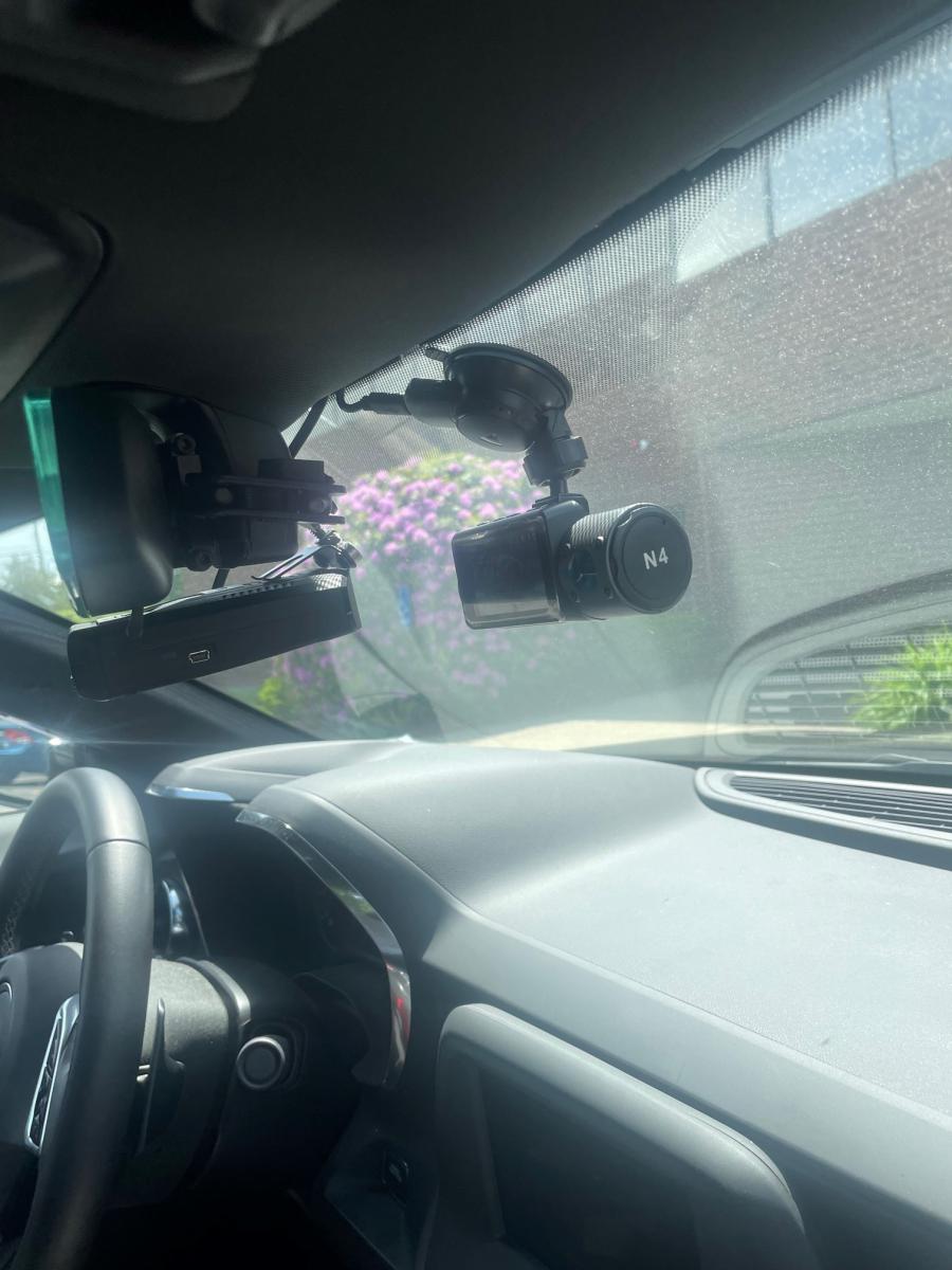

On today's episode: Radar detector and Dash Cam install.
I have a Uniden R3 that I want mounted w/o suction cups and hardwired. I used the gen5DIY harness. It is a plug and play piggy back off the connector that goes into HVAC module (under the passenger side kick panel) to get +12V w/ignition. It also has a capacitor which apparently is needed to smooth voltage drops, I guess an early version w/o the cap had issues where occasionally the radar detector would inadvertently shut off.
Anyway it tucks in seamlessly under the headliner. Routed up the C pillar, it hides nicely behind the fabric. Just like the instructions state, pop off the dome light and anchor the wires to something there before drawing them out and going directly to the detector. FWIW That dome light was a PITA to pop off, maybe I was being too gentle but I didn't want to break anything, I had to use a few plastic trim tools to get it off:

I had one of these left over from my last car:
Name:  mirror mount.JPG
It is supposed to work like this but our Camaros have a somewhat unusual mirror mount so I had to get creative:
I bought a second one to be sacrificed. I cut and welded it up to make third joint.
I started rushing so no pictures of it re painted black, or the final assembly before I put it on the car but here's the final product. Note the way it wraps around the mirror, kind of crazy but it works.
