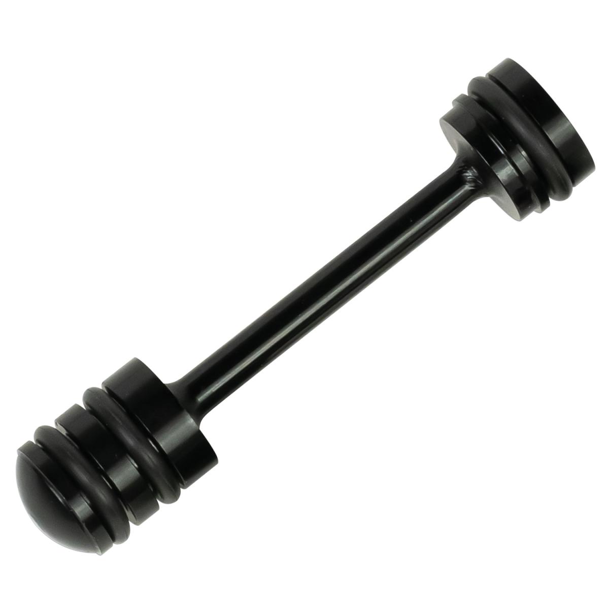

Hey brotha, I'm not sure how you feel about it but you may want to consider changing that barbell back out again to a Derale unit because the Derale has a double seal built into it and based on the HP that you'll be making I'd rather see you have that over the single seal version due to the possibility of blowout due to seal failure from excess pressure. It happened to me on my Katech dual in tank pump (the fix was to move up from a single o- ring seal to a double o- ring seal) and I know it's not an apples to apples comparison obviously, but it does have to do with seals, o-rings, and the issue with single vs. double redundancy.
Attachment 1173662
What kind of oil pressure would you be running to blow that seal out?

Yeah, I'm not pulling that cover back off. It would add, like, 9 months to my project. Lol

Just to give you an idea of the pressure that blew my ring out, it was only 80 and intermittent at that. The double stage oil pump is well capable of pushing that sort of pressure intermittently as well, and then add on to the fact that it's a narrow passage way and the ring is working that much harder to seal. I wouldn't want to risk it personally.
Oh man... I totally get it, but yeah... The way above highlights how I feel about that sort of stuff. I deal with all that stuff the day I take it all off so I'm a little bit of a different builder situation than yours I see.
