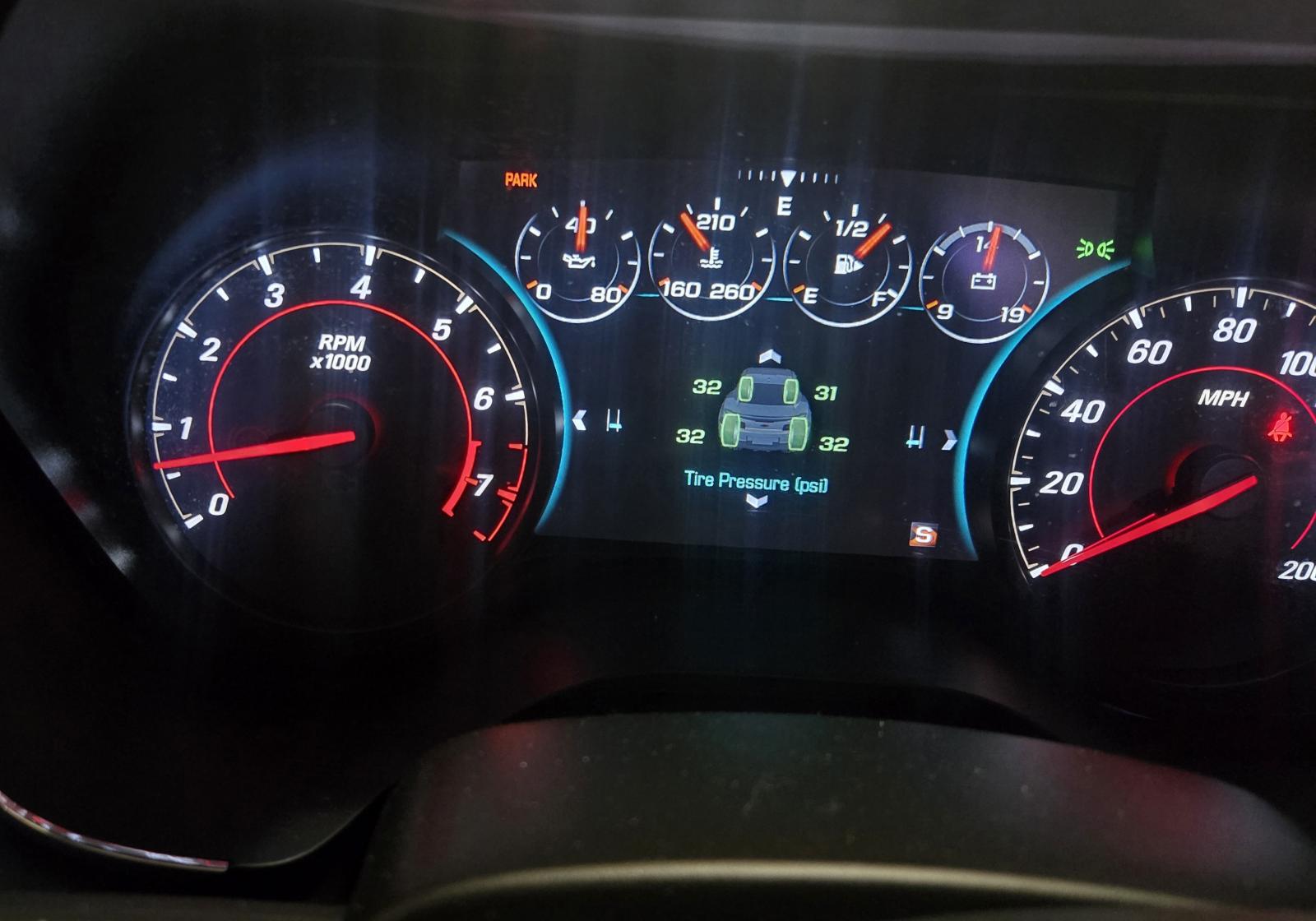

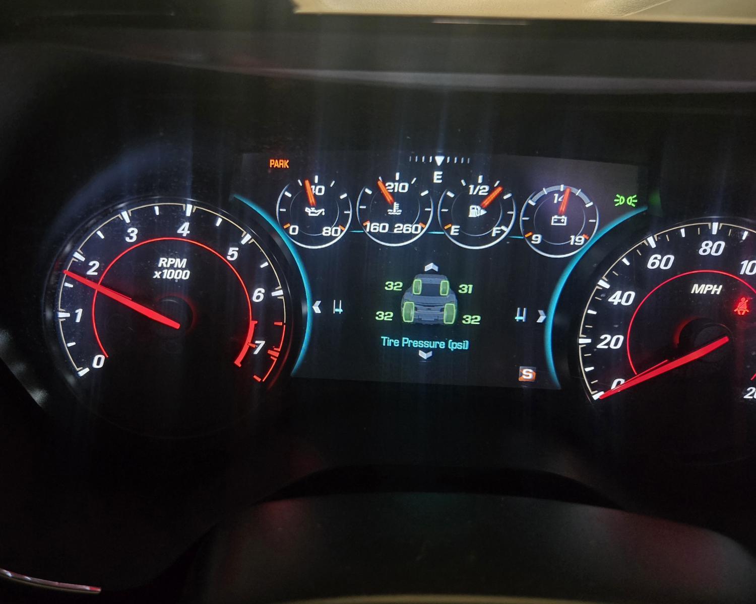

This is just for information purposes. 108k miles on stock oil pump, idle vs 1500ish

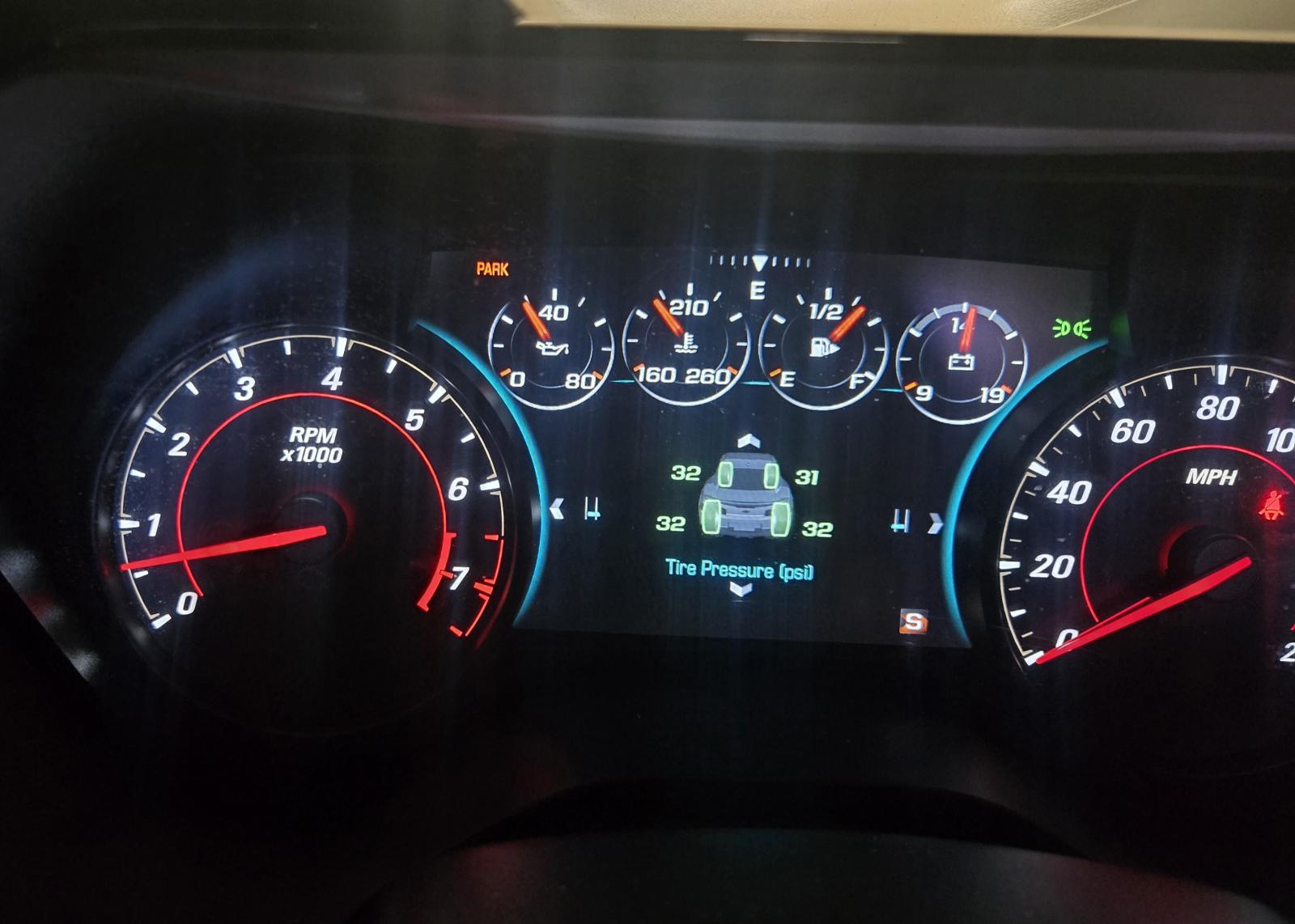

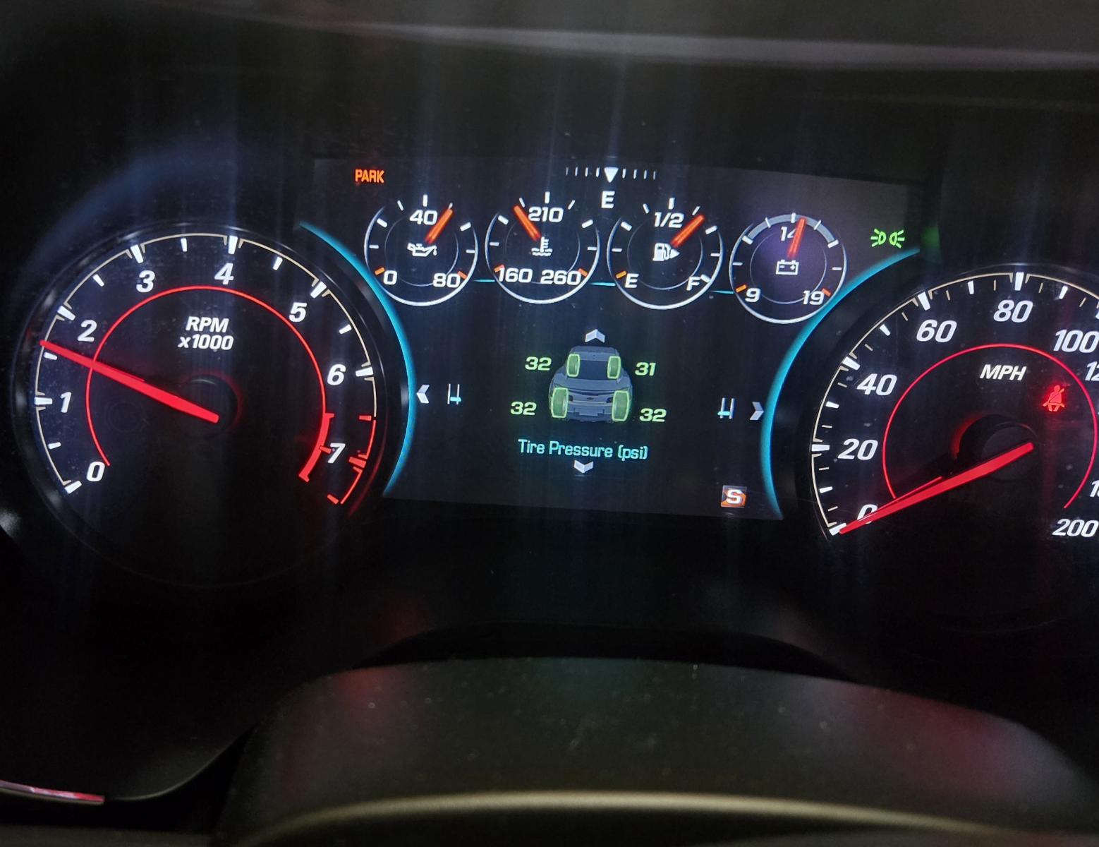

This is the same time and test but with the oil control valve turned off.

2500rpm with the valve turned off it will hit 60psi. The question I've been wondering is if i left it turned off would the higher pressures break things?
