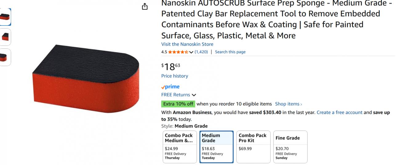

Im surprised more haven't been on board with a clay bar. I've had my entire car covered in over spray. I also am a hobbyist detailer with a small customer base. I highly recommend a sponge clay bar and a good lubricant like ONR or even Windex. Little to minimal effort and you'll be golden. I've used this for years without issues. You can use the fine or medium grade. Personally I would stick with the fine. Follow up with a waffle weave glass cleaning towel (rag company)and automotive glass cleaner (sprayaway or invisible glass) for a streak free finish.
Just glide this over your glass or paint with adequate lubricant. No need to scrub.
https://a.co/d/2qHLoKQ
