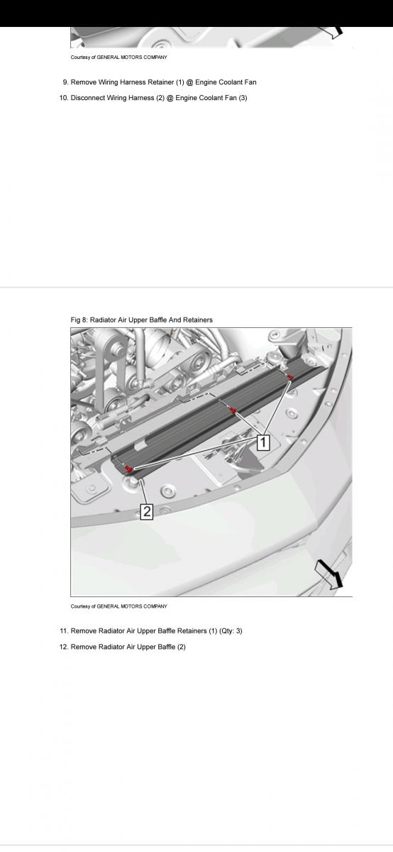

Can someone post the steps for radiator removal for the ZL1?

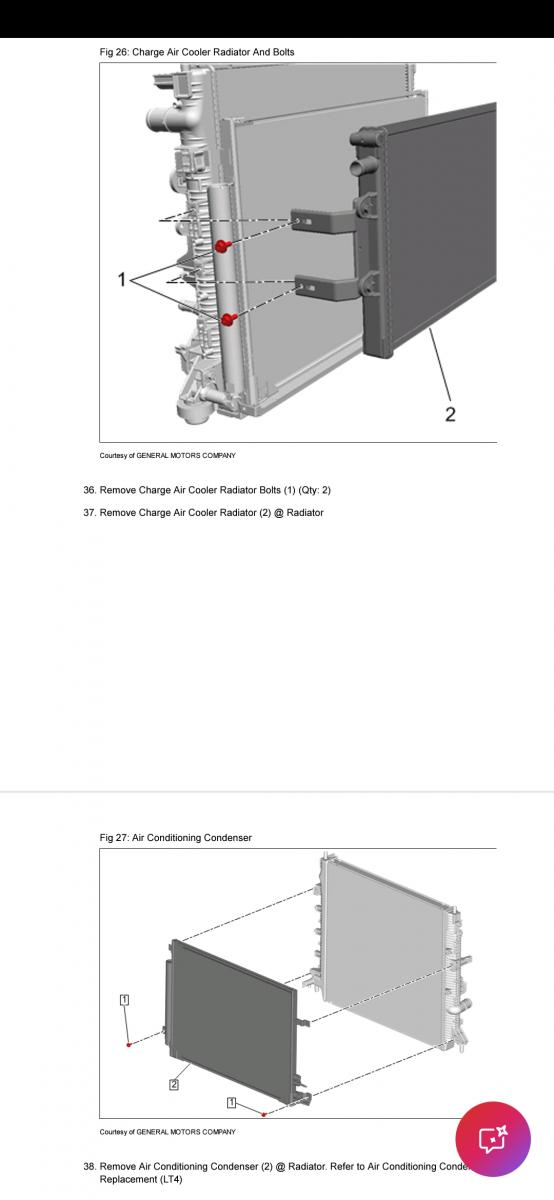

Thanks. Yeah, that seems consistent with what the manual says. I ended up taking the car to the dealership. They seem to like me there. I will probably get banged out to some extent, but not raw dogg.
I ordered the replacement radiator and will drop it off for them in the AM. So it should just be labor plus any lines, hoses, O-rings if any, etc.
