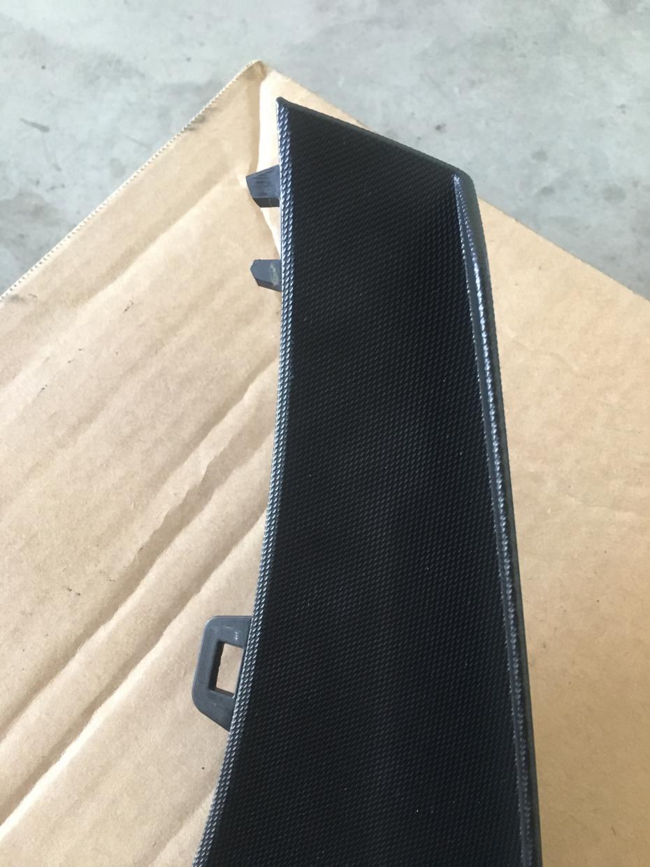

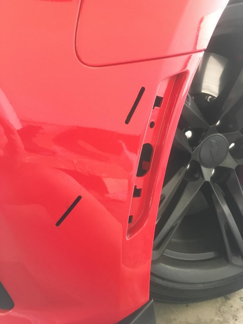

It was pretty easy. All that's required is to remove a few screws from the fender liner and remove the side marker light. There are clips that go into those openings on those tabs. Note the top tab was broken. If I remember correctly, there are 2 that you access thru the inner fender and 4 more that you access by reaching right into the opening of the bezel.

Clips - 11547341 $5.32 list. I paid $4.22 from Mathews GM Center, Inc.
Driver’s side “Deflector” / Dive Plane - 23329726 $65.23 list. I paid $45.40 plus $8.50 shipping from That GM Parts Guy.
I ordered 1 clip but, I didn’t end up needing it. The old one was found and reused.
Sorry for the delayed response as i had company.
