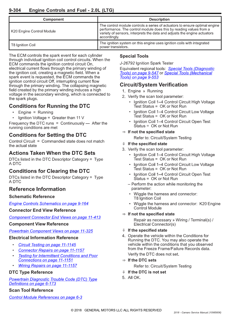

ignition feed is from one fuse labeled
coil odd fuse
wire color is purple\blue and all coils have that wire
the Black\Blue wires they all share are low reference which is pcm ground
the pcm side of that is connector X2 cavity 44
yellow\blue is the coil control wire for cylinder 4
pcm X2 cavity 66

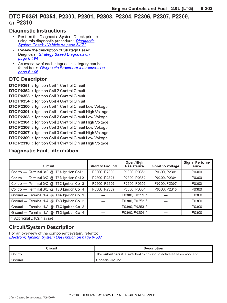

Initial issue:
Ignition coil connector (cyl 4) got burnt, likely from a failing coil zzp highV
Started with intermittent misfire on cylinder 4
Wiggling the wiring near the connector would temporarily fix the misfire
Codes observed:
P0354 (Ignition Coil D Control Circuit)
P0300 previously (random misfire)
StabiliTrak warning appears when misfire is active
Work done so far:
Replaced ignition coil (multiple swaps tested, no change)
Replaced spark plugs
Repaired coil connector:
New connector housing
New pins properly crimped
~15 cm of new 0.75 mm² wire added
Verified:
12V supply at coil = OK
Ground = OK
Current situation:
Constant misfire on cylinder 4 (no longer intermittent)
P0354 comes back immediately
No change when wiggling wiring anymore
Engine runs on 3 cylinders (cold worse, slightly better warm but still misfiring)
Im planning to verify continuity of the trigger and feedback wires based on that diagram another user posted, THANK YOU very much for that by the way.
Other then that i ran out of solutions, please help.

Definitely could have destroyed the coil driver in the ECM.
I haven't seen that in a while but it is a thing.

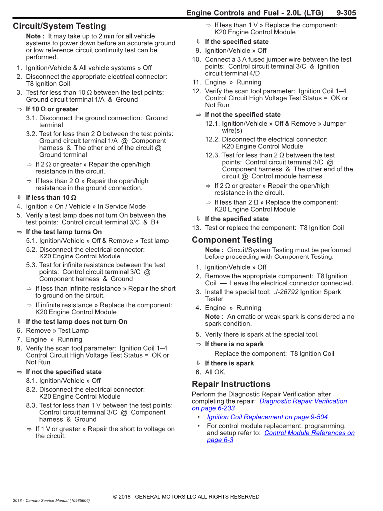

Coil primary circuits are pretty simple circuits.
The coil is charged by applying power to one end and ground to the other. The wound wires create a magnetic field, break the circuit and the field collapses in the form of a high voltage discharge into the steel bar in the middle of the winding, which is where your spark plug wire attaches.
So the fusebox supplies the power in. Its going to be key hot and shared with the whole bank. Meaning if that fuse is bad then all 4 on that side will be dead.
Ground is suppled by the PCM. Its coil driver is an internal trigger mechanism. Simply connect to charge the coil and disconnect to fire the coil.
Since you dont have 4 dead coils it's not the fuse.
Since you don't have a dead vehicle its not the PCM ground.
It leaves you with power wire from the fusebox to the coil, trigger wire from the coil to the PCM, or the terminals at any of those connections to test. If all of them are good then your coil driver has failed and you need a PCM.
Very simple to test. Go to the point of connection at the pcm for the trigger wire. Key on engine off you will have battery voltage. That will test all of the wires and terminals in that circuit from the fuse.
If you don't have power there then look for power at the coil, both wires should have power. If one does and the other doesn't the coil is shorted or you have a broken connection in the connector.
Since you have replaced the connector. Double check your splices and make sure they have continuity. Dont twist wires together and tape them. Solder and heat shrink is easy and better.

Hi,
I must say I'm very grateful for you guys's time and effort into my case.
I appriciate it very much.
I did indeed solder the wires then insulated them with heat shrink and then tsl tape then back in the harness's plastic conduit. I do have 12V and Ground checked , So it does points to the ecm circuit.
