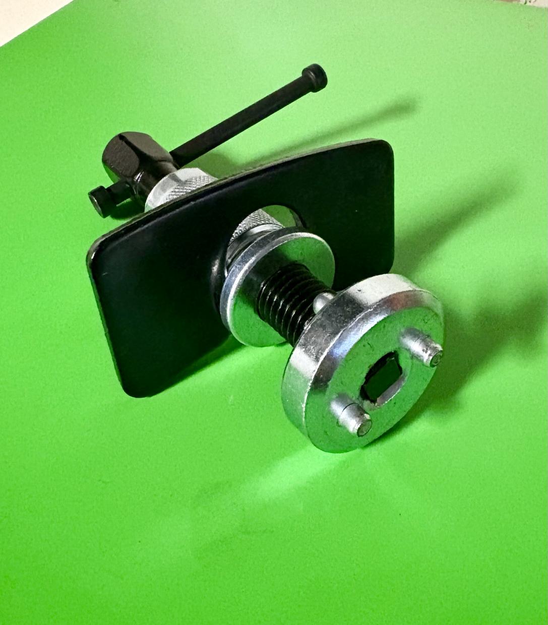

No need to retract. Just don’t set the parking brake when you start. Easy job to do just make sure you have something like this as the caliper will need to be “twisted” back in.
