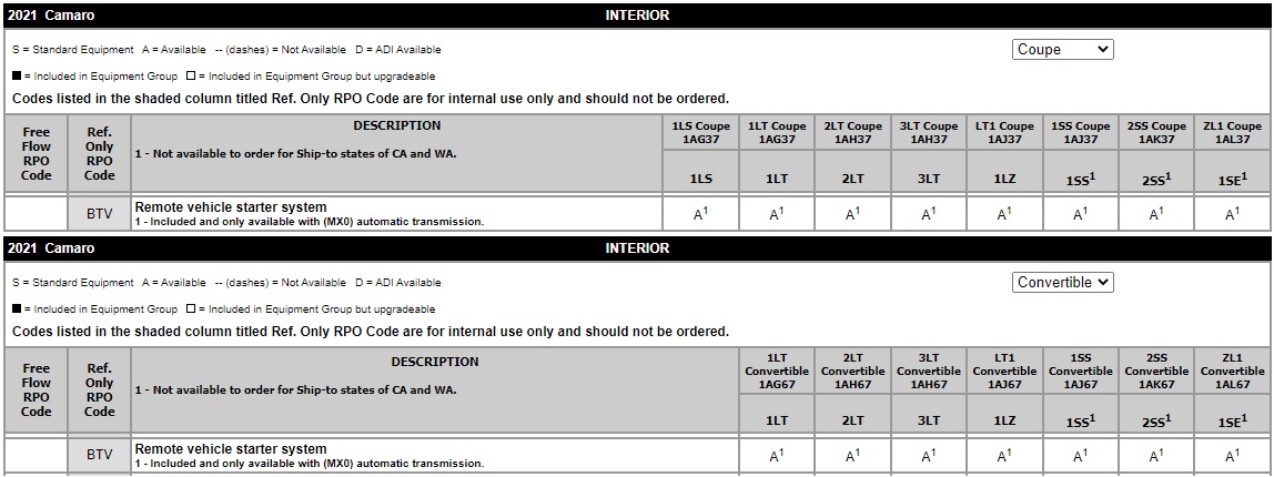

The 2021 Fleet Order Guide indicates that all 2021 Camaros with an automatic transmission included Remote Start. Which model do you have? Did you buy the car new or used?
If you bought the car used then it is possible that you received a FOB for a car with a manual transmission that doesn't include Remote Start.
