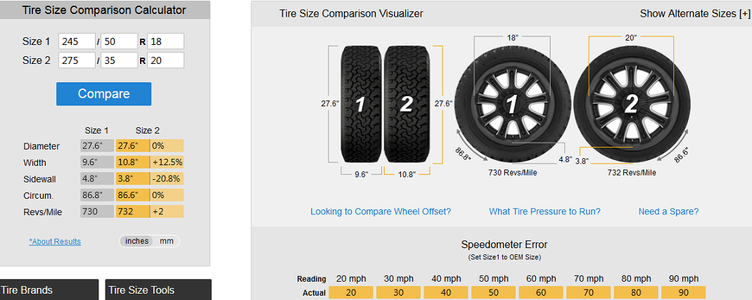

The tires will be different for the 20" wheels, you'll have much less sidewall, so the overall wheel+tire height can be kept very similar to your current setup. As long as it's within ~3% and you don't change the rake (front/rear height ratio) excessively, you should be okay. The speedo might be a little off, but probably not by much. You can check the impact of various tire sizes yourself at https://tiresize.com/comparison.

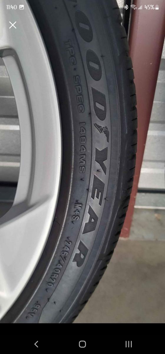

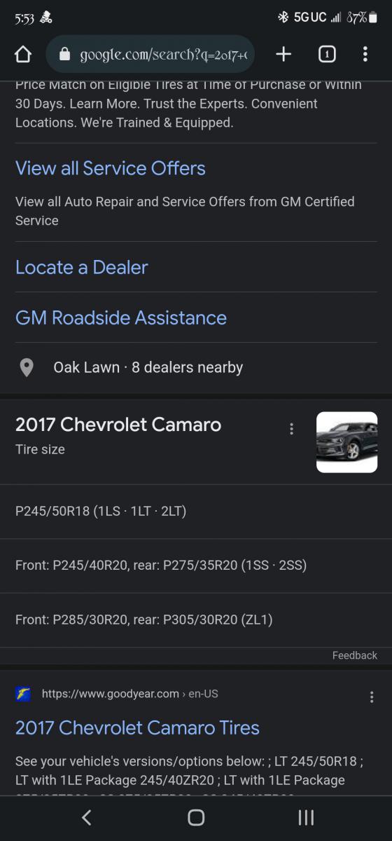

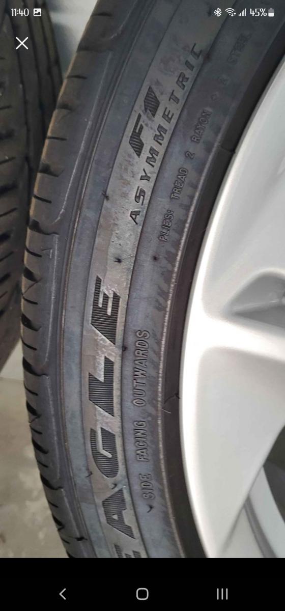

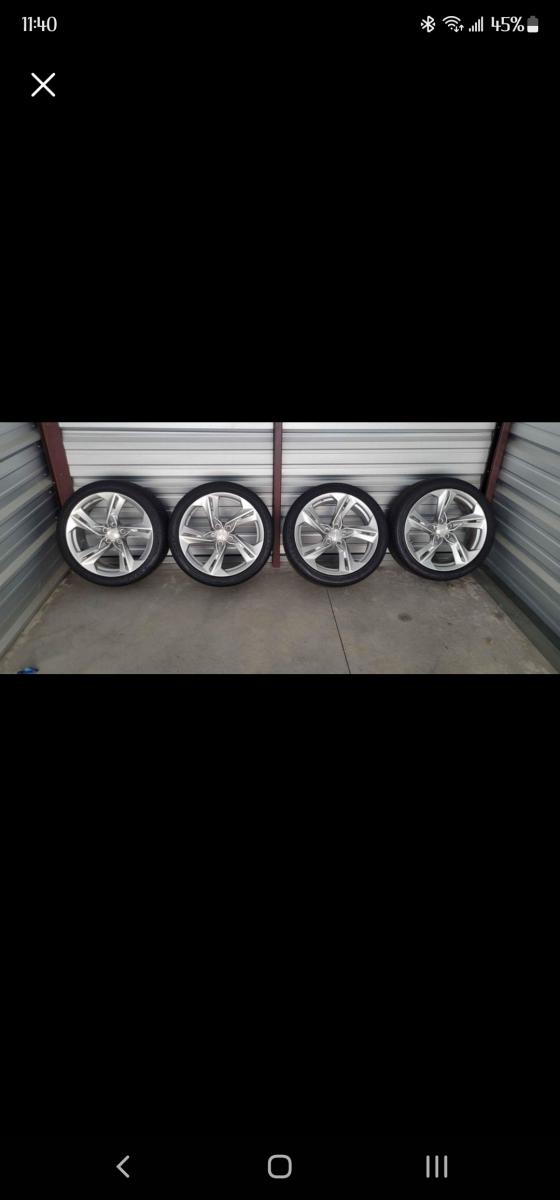

Hello I know it's an old post but I'm hoping to get some help myself. So I was actually trying to do the same but now idk what to do. My camaro is a 2017 LT and I have the oem 18inch rims. I bought another pair of oem rims 20inch fem a 2019 camaro and was told it would fit my car. Well I took them to get out on my car and was told they would not work and advised not to put them on because I would have room to turn. I attached he'd pictures of my oem rims and tires with pictures of the tires I bought. Hope to hear from you guys I'd really appreciate any and all your help. Thank you.

Who said they wouldn’t fit? It’s the OEM tire size just for a different model lol

Check out this tire size comparison, your rears will have the exact same height (diameter) down to 1/10th of an inch, your ECM probably won't even be able to tell the tiny difference in circumference. The fronts will be ever so slightly different, nothing to worry about there either.
If you're concerned about physical fitment, there is enough space in the wheel well for these slightly wider rear wheels (there's actually a lot more room), and the fronts are the same width as your 18 inchers. Go ahead if you like those 20" wheels/tires and you're okay with their disadvantages.

This doesn't make any sense. There's no reason they shouldn't fit unless your "shop" tried to put 20 x 9.5s on the front...
Look at the backside of each wheel and verify they're all identified as 20 x 8.5".

So I checked the wheels they all say 20x8.5. Looks like I'm putting these on myself! Thank you!
