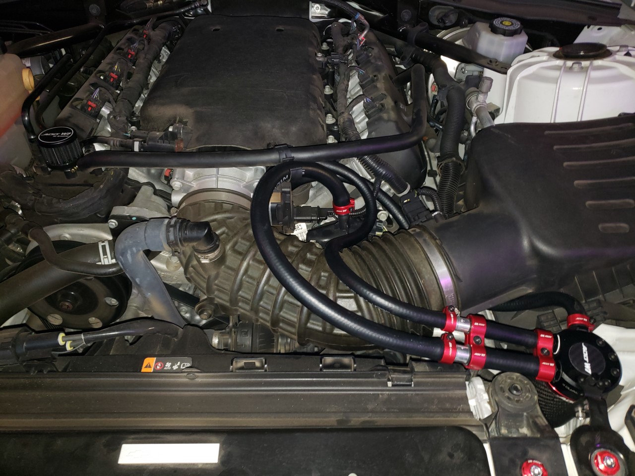

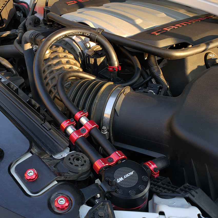

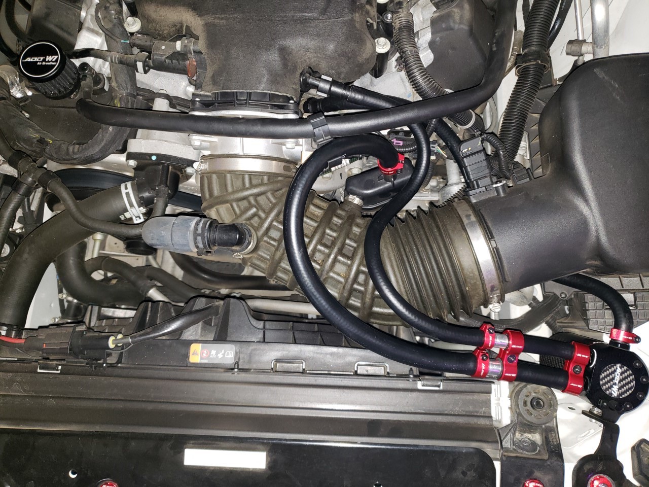

Here are the extra pics ADD sent me that are not available on their website:

Hey those bottom two are mine! I asked for help too and then afterwards they asked for pics to use
