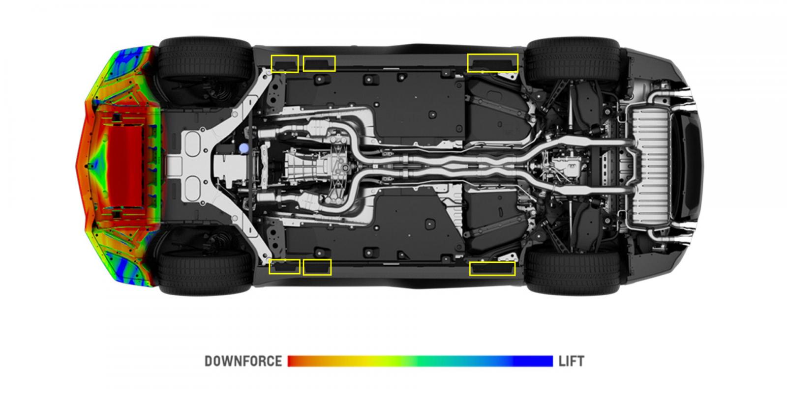

Have a Spare tire. Where is jack placement on the car?
I just purchased a Modern Spare tire for my 21 Camaro SS. Can anyone tell me where to place the jack for jacking up the car? I am ready to go on a trip and I need to practice putting the modern spare tire on the car. I need to know how to jack the car up properly. Could not find anything in the owners manual. Pictures on where to place the jack would be appreciated. Thanks a lot

Here you go. The car has 4 official lift/jack points, and you should use the pinch weld as indicated in the picture to jack up the car from, NOT the seemingly obvious locations with round holes in a flat part of the subframe (as far as I know, those are only meant to support the empty unibody in the factory and will not be able to support the entire assembled car).
I think the additional two points in the front where you see the extra notches in the rocker panel are also safe to use.
Note that the unibody is so stiff that jacking either the front or the rear will cause that entire side to go up in the air.

Also, get a pinch weld adapter so you dont crush or deform the pinch weld by jacking only one point.
Sometimes the pinch welds dont take kindly to being used one at a time. They are mainly meant to be used by a 4 point lift. Ive always used 2 jacks in tandem to do at least both front points or both back points at the same time. I know this isnt practical on the side of the road. Just be aware using only one lift point, especially on uneven ground can permanently damage the pinch weld. A pinch weld adapter will lessen the risk if it does become necessary to lift it.

Also you don't need to get a pinch weld adapter either.
You can access the frame itself without touching the pinch welds I believe.
Better to probably use one, but I believe you do not have to.

When I would swap my summer and all-season tires I'd jack from the second position from the front. The car is so rigid both front and rear wheels will elevate.
