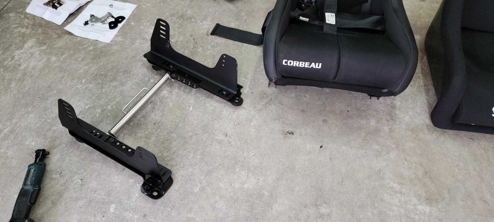

Originally Posted by beworthy3 View Post
Where are you all mounting the sub straps and shoulder straps for the harness. I have the planted seat bracket, side mounts, and a recaro slider with CMS bar. I plan on putting it all in the car when I get a warm day to do so.
The shoulder straps will mount to the 4 point roll bar, and the sub strap goes to the crossbar on the BK base. The BK base also has one anchor point on each side of the seat(not shown in pic) to attach your lap belts to.

Don't have time to post pictures right now but the answer is in the comment you just quoted. There are anchor points on the BK base that the belts attach to. I will post pictures later today so you can see what I'm talking about.

Here are pictures, my car is still dirty as hell from last track weekend.
