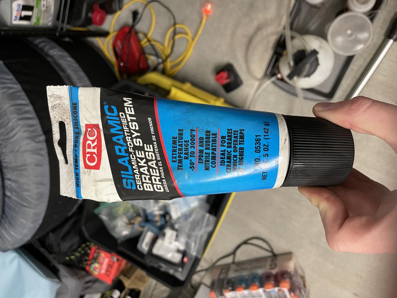

Aug 7 I applied some brake system grease from CRC to the back of the GS1 pads. They were doing some squeaking with turns under no braking and now power. The squeaking did go away. I would expect that I probably applied more than needed. But I don’t think it was a ton.
