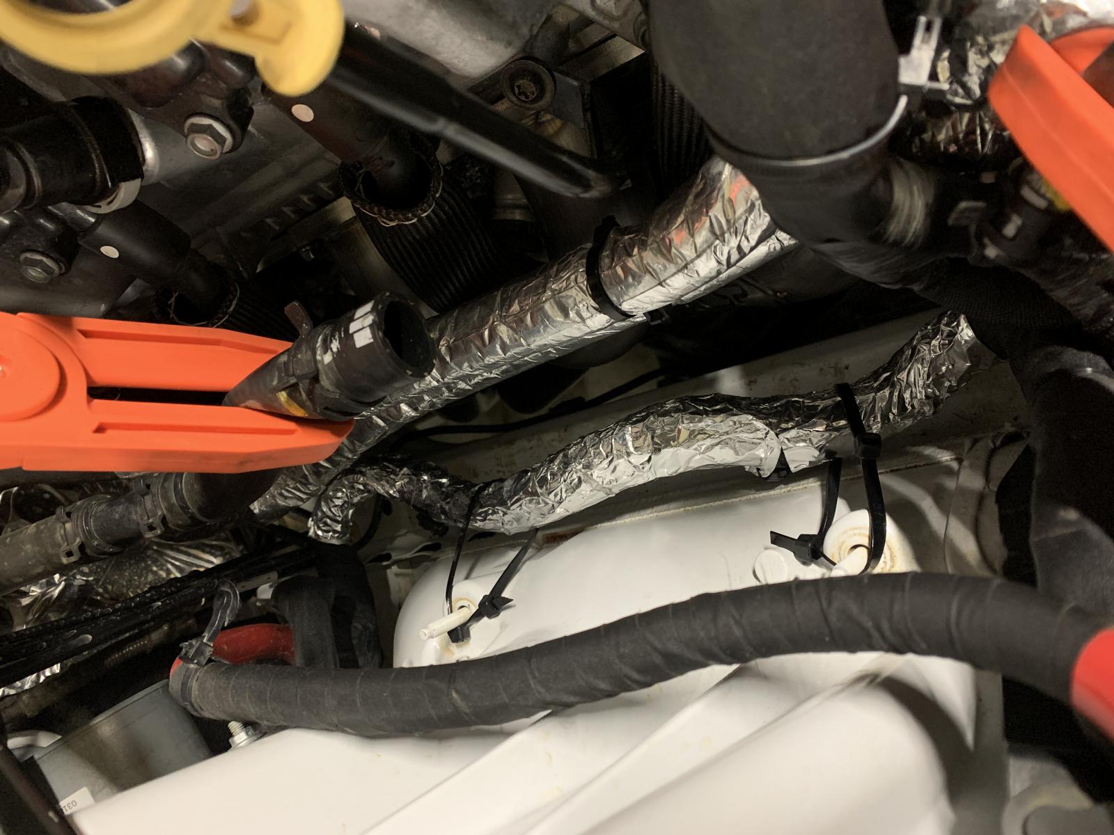

This would be my first thought as well. Look at the wiring harness that runs along the body inside the engine bay under the coolant reservoir on the passenger side. It runs VERY close to the headers. I wrapped my in heat shield and zip tied it back about 2" from where it normally lays to try and give it some breathing room from the headers. This is looking straight down where the coolant reservoir would be sitting.
