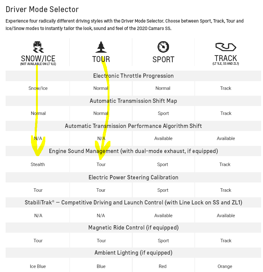

Is Stealth Mode Available in the LT1 Trim with NPP?
Hey guys, question for all, I am looking at an LT1 trim camaro with the NPP exhaust.
Is the "stealth" mode available under the touch screen?
As many others, I do not want to upset the neighbours at 5AM
Or is this a SS thing only?
Cheers,
Jason

Any Camaro with the NPP option should include all 4 of the exhaust modes (stealth, tour, sport and track). Either tied to drive mode or changed through the settings on the screen

LT1 has stealth, tour, sport, and auto (follows drive mode). It does not have a track option. Stealth really quiets down cold start, which is pretty loud in tour or sport. Only catch is you have select stealth mode manually in the vehicle settings every time you want to use it.

LT1 has Stealth, Sport, and Track.
I believe the Snow/Ice setting will put you on Stealth without choosing through the menus.

Old 12-01-2020, 10:18 PM   #12
Posts: 13,436
Originally Posted by bryanw80 View Post
I don't have a stealth mode in my 2020 LT1. Have Tour, Sport and Snow/Ice...Snow/Ice and Tour sound exactly the same to me
I'm sure they are different, not at idle but at higher rpms. There is no 2020 LT1 tune in the HP Tuners repository, but 2017-2018 stock tunes and mine all indicate a difference.
https://www.chevrolet.com/content/da...art-072319.pdf
