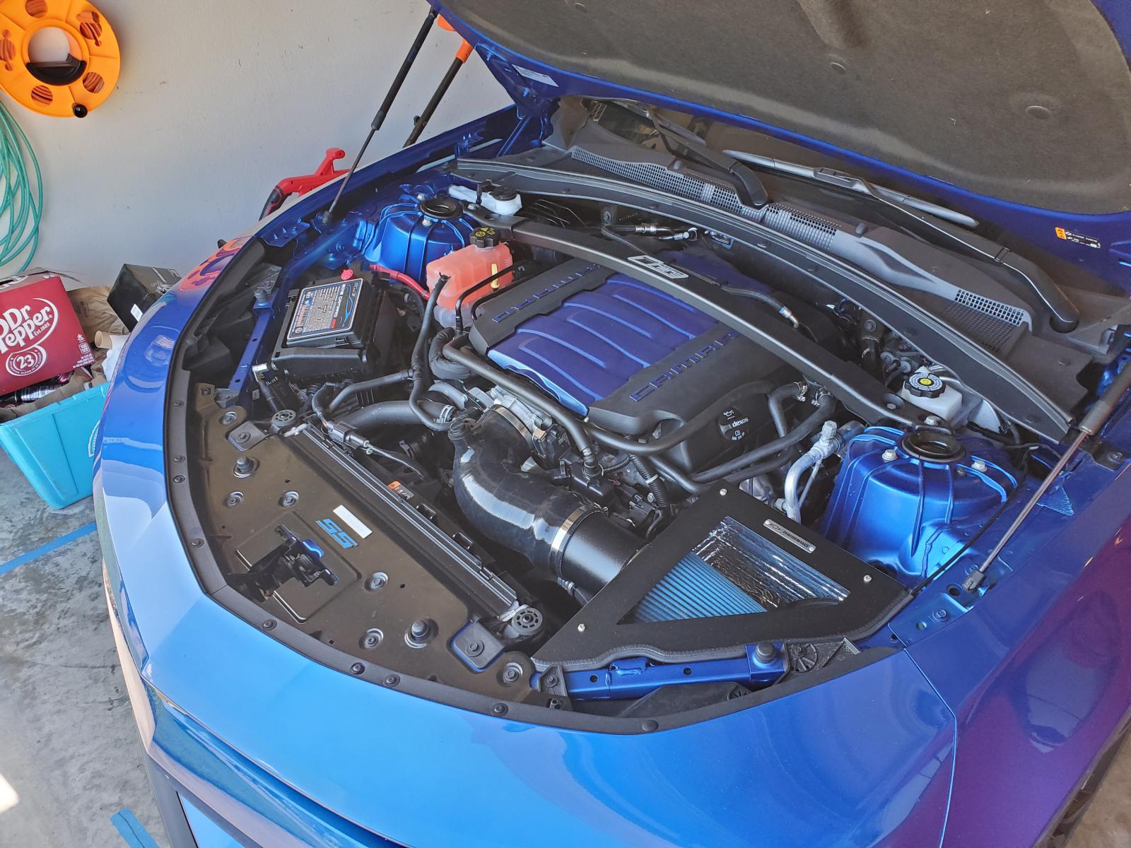

Just to repeat what people are saying. The stock intake is already a CAI. I still bought the GM intake because it looks great on a blue car
