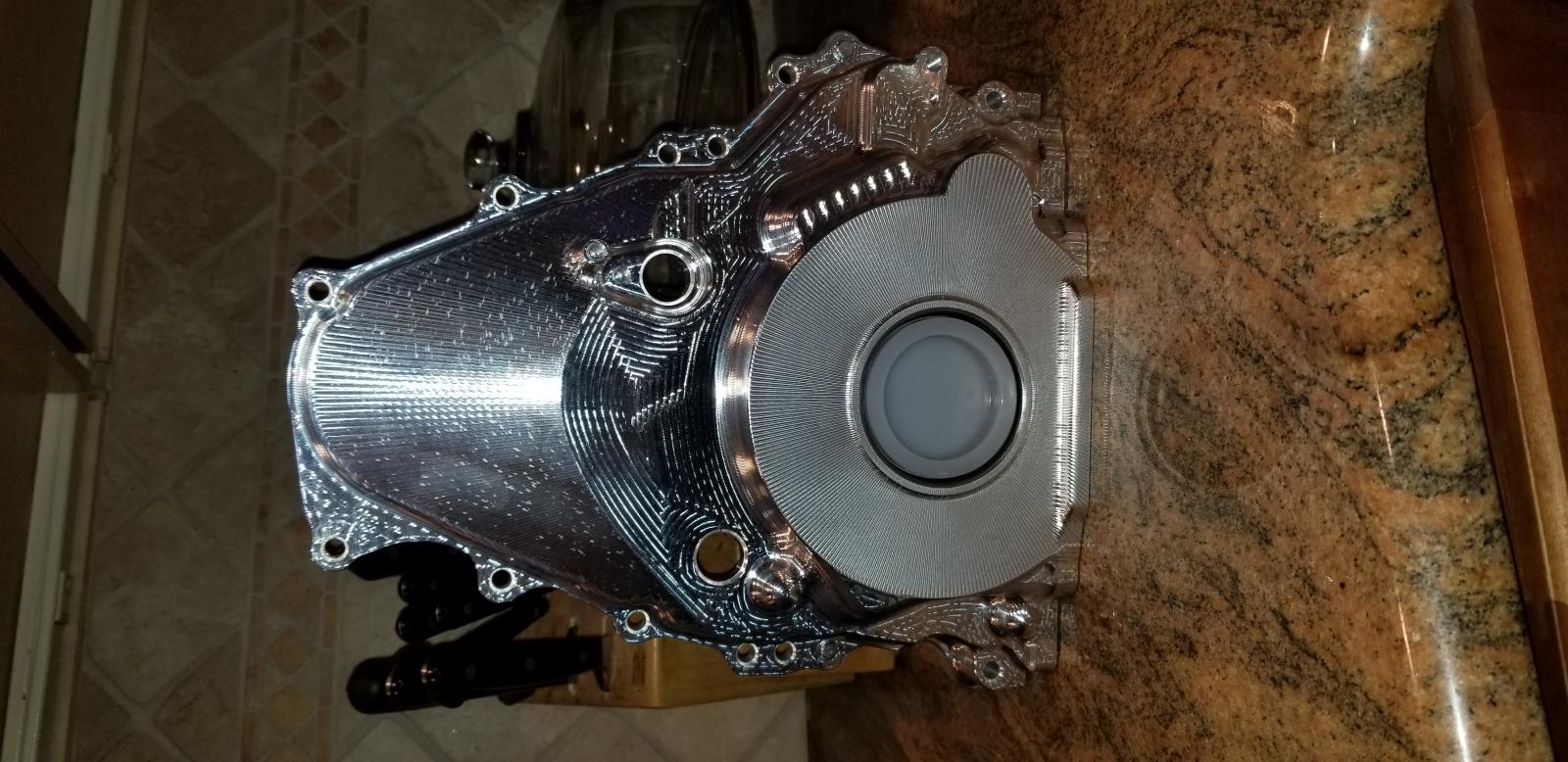

Yea - the part being left out is that you need to spend another $700 for the special cam and the billet alum cover from Katech that lets you run the LS gear on the LT cam

500 from cam motion

500 from cam motion
The cover is $500, but the price for the "VVT Delete" cam goes up $175 also (for the same spec cam)
I would like to run this setup, but can't justify it at this point

Originally Posted by parish8 View Post
I didn’t know you needed a $500 cover. Ouch.
Need it for two reasons - first to control the axial thrust on the cam with the LS gear on it (since it does not have the whole phaser setup on it - it is substantially thinner) and the second is that they have to move the cam sensor over to the location where it is on the LS engine as the reluctor setup on the LT is different vs LS

500 from cam motion
Bought one
