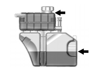

The way I read the manual and interpret the diagrams is that I should keep the upper tank completely full and the surge/overflow (lower tank) filled half way. A couple of years go the surge tank on mine was dry. I added coolant per the manual and have been good ever since.

This is correct. The upper tank must always be full 100% of the time. The bottom tank is the one you add fluid to to keep it between the marks (~ 1/2 full) which of course are hard to see.
Great design from an engineering standpoint to ensure there's no air in the loop, but horrible from a owner/maintenance standpoint.
This manual page shows the purge procedure as well as a good graphic of what the two tanks should look like under normal conditions (hot or cold).

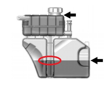

I filled up mine a little bit, used up 300 mL(10 oz for Americans) of the mixture. My measuring cup made filling the bottom surge tank pretty easy. I just bought some AC Delco DEX-COOL, though I'd imagine anything DEX-COOL is fine. Colour will be a little different, factory fill is pink while coolant from botttles are orange.
As for the fill line for the bottom tank, if you look close enough, there should be a pinch in the plastic on the bottom tank near the halfway point, which you can use as a reference when filling up.
