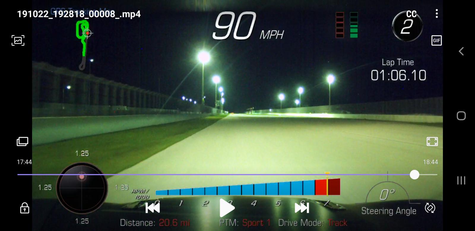

Hi guys had a track day a few days ago and hit 2nd instead of 4th. I know stupid. Anyways it was caught on my pdr. I backed off as soon as I realized it which was really quick. It was my last session and the final lap of course. Drove it 2 hrs back home and didn't notice anything. Think I'm ok?

90 in second gear should be about 7400rpm based on quick math and stock tire diameter. That doesn't sound too bad to me.
If it doesn't seem down on power and isn't making any scary noises, you're probably ok. Maybe change the oil and check the filter for any bits.

Jonny, I wouldn't worry too much... Red line is 6500RPM and it looks like you went just 500 above for a bit.. As others said, it did not grenade itself right then and there.. get an oil change and it should be good for 17 Nov Sebring!
