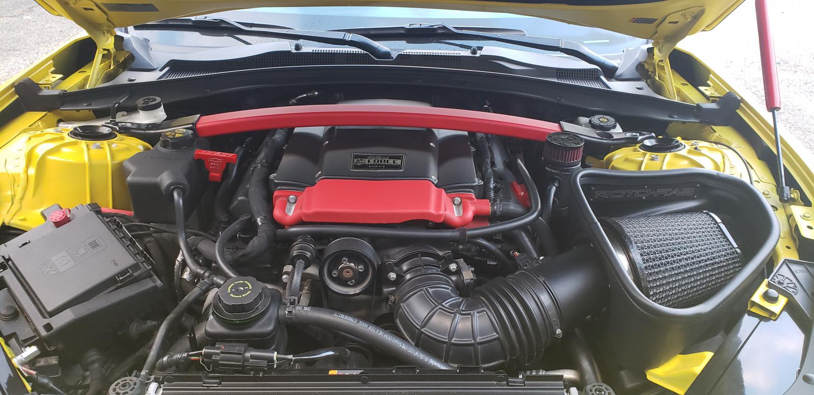

Get the dimensions of the blower from tech and then get the dimension on the one your looking at to see if the height is ok.. about 3/8 clearance.
The brace would not fit my oem zl1 if that helps.. I could of ran some spacers about 1/4 under the brace it might of fit but I doubt it would do any good and be only for looks..

Posts: 525
Works on Procharger but puts a nice little dent in the intake filter.
50th Anniversary Edition |Borla Atak and 60606 mid pipes| Kooks 1 7/8" | ProCharger Stage II |305/45/17 DRs | Circle D 3500 stall | LT4 fueling | Custom made Lowside Aux Pump | Alky Control Meth | DSX E85
