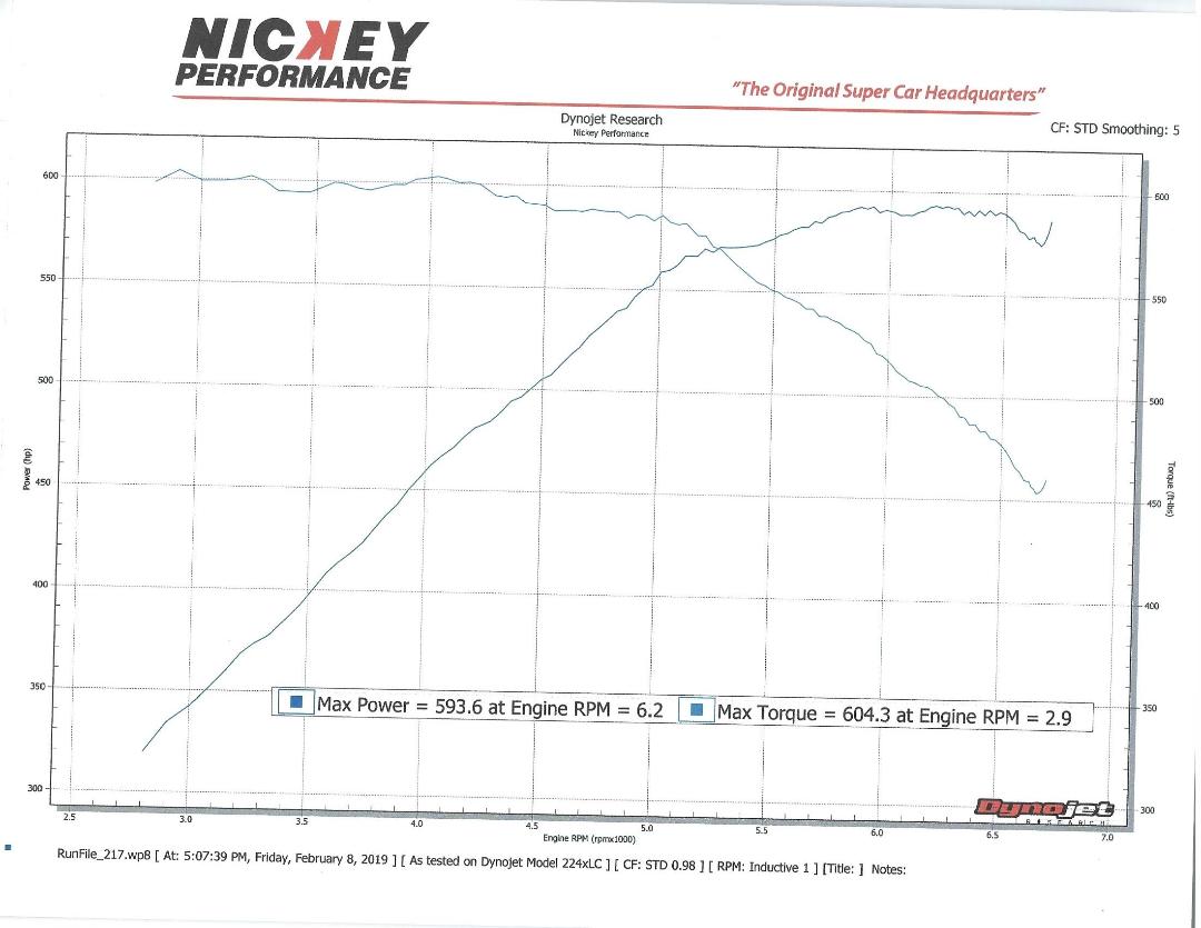

Thanks gain to Ryan for doing such a nice job, building and tunning this 1LE as well as maintaining it in pristine condition.
It features:
GM LT4 Corvette Supercharger and Kit from ADM
2.7" upper pulley
Fleetliner HD Belt
Stainless works catback system (still has cats)
NicKey Performance Tune by Matt Peckham
We looked over the tune file and were ready to make adjustments after our baseline.
I'm posting numbers in STD vs SAE (3.0% higher/approx) but will post graphs with the baseline both ways.
While the tune is safe and based on 93 octane fuel, it is at the limit of the stock LT1 fuel system.
I have dubbed this 1LE Kryptonite
Stay tuned for future upgrades.
