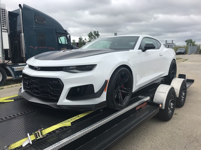

I forgot I had a picture of it on the trailer.

Is that a MaxxD trailer?

Yes it's the Maxey Drop-n-load.. Love that thing
