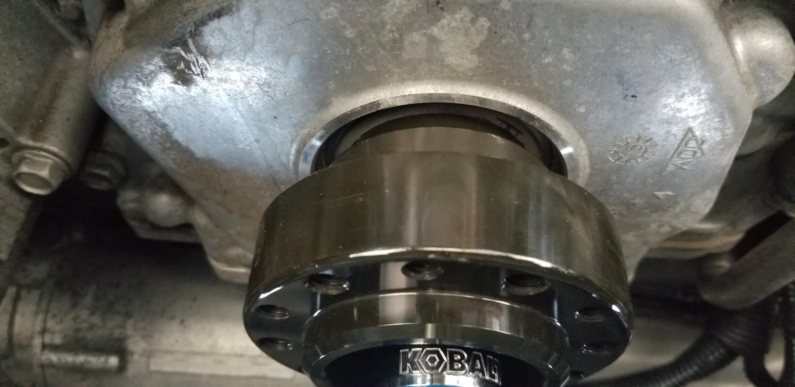

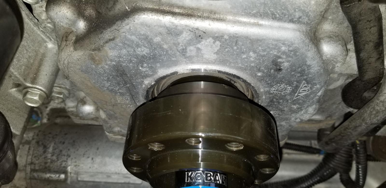

Hey does this look fully seated???

Doesnt look right to me
