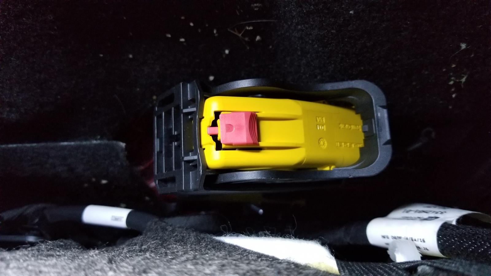

Remove the 4 bolts using a T50, ratchet and extension. Then under the seats, each one has a wire connector that needs to be disconnected. As you can see they have a little red tab that has to be pulled back and this allows the big black leavers to be pulled open to release the plug.

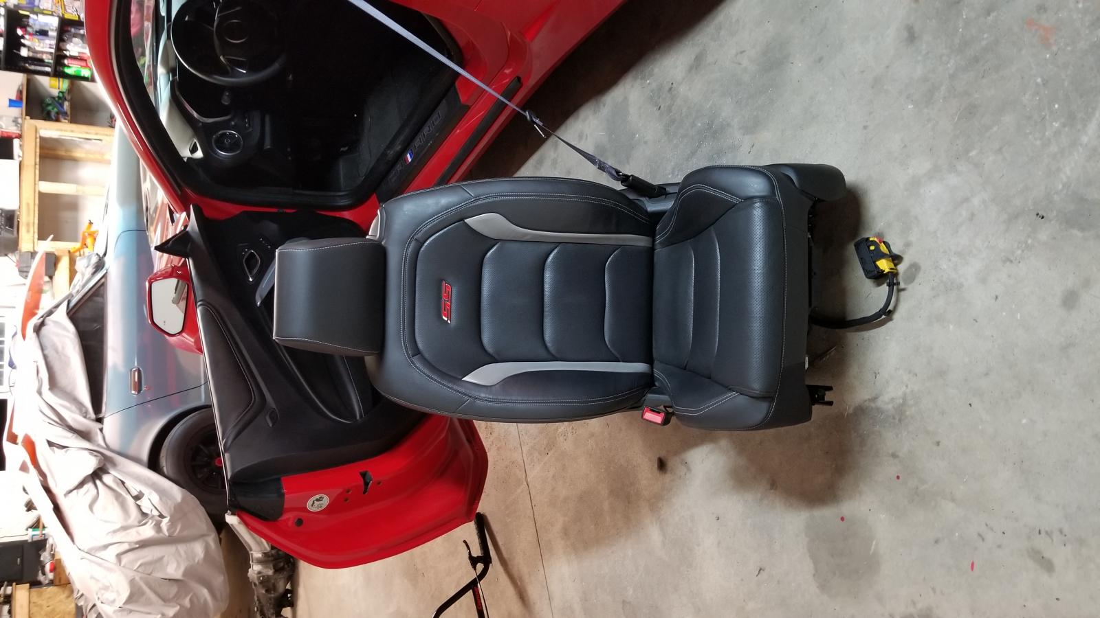

With that being done go ahead and pull out the seats, this part may be easier with 2 people to not damage things but I was able to do it myself. Yes the seat belt is still attached, I will show where I believe it comes apart at but I was able to do it all with it still attached.

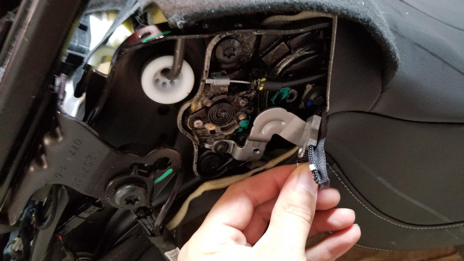

Now you can see the pins (screw driver pointing to what they look like in picture) that need to be removed (total of 4, 1 each side of each seat, some people only drill out 1 on each seat and then "snap" the other with body weight/power of the motor but I would not recommend that). There are many ways to go about this part. I used a drill with a small bit then gradually made the hole bigger untill I seen the pin was no longer attached. I seen some people use grinders which I wouldn't recommend as the sparks may damage things but this part is at your own discretion.

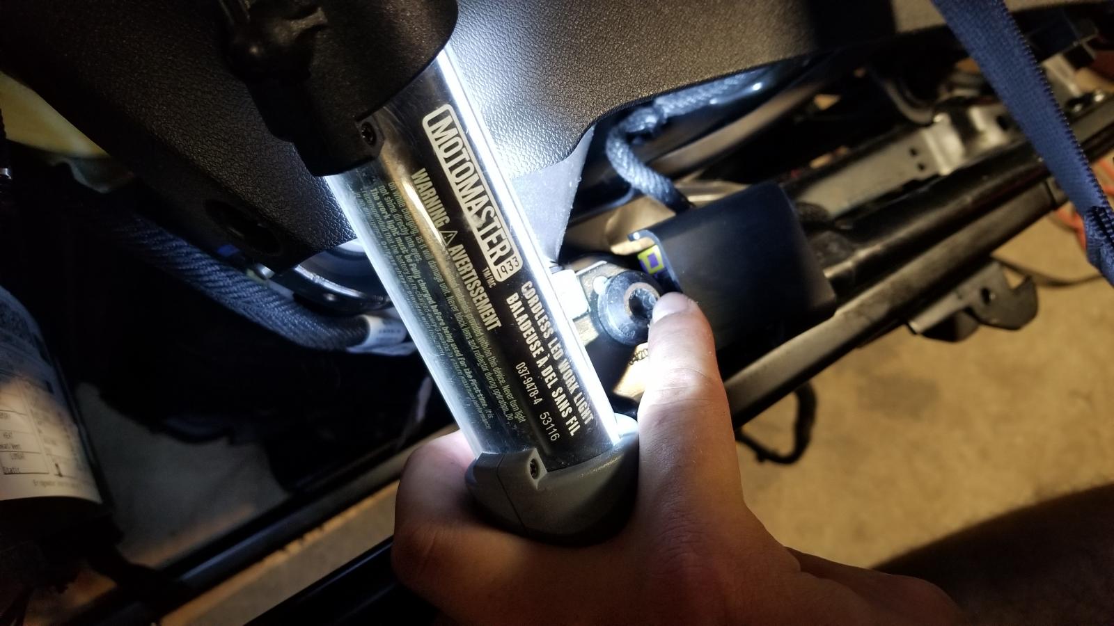

Here's a few other random pictures, a picture of where I think the seat belt come apart at (Also looks to have a wire/plug that needs to come apart) and of course a picture of the final product!
