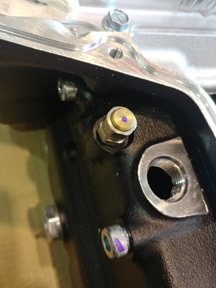

One of my friend having Whipple S/C detached SC to install new injectors and found the charger oil leaking.
It is from a kind of filter on SC.

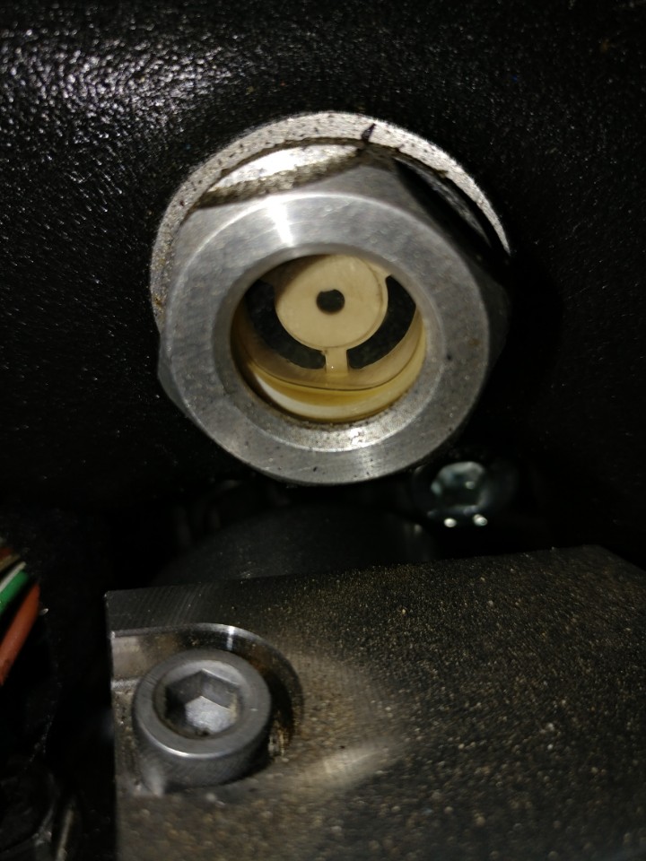

So I checked mine today...seems there was a leak.
The level got lower than before.

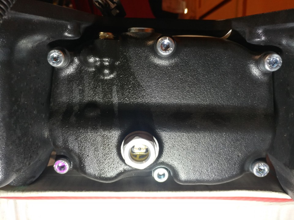

And I found a recent SC kit got modified.
The below is a new

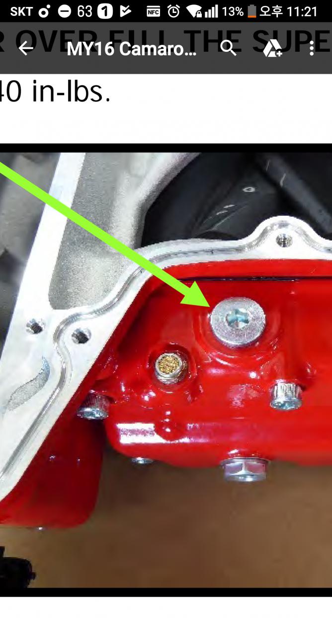

And this is like mine. It is from the manual.
The filter is blocked...
How about the other guys?

I have the brass vent also. Car is in storage, so I can't check to see if it is leaking.
That updated one looks like a pressure release. I bet it is spring loaded, pops to release case pressure when hot. Much better idea, not much room to elevate a hose or tube.

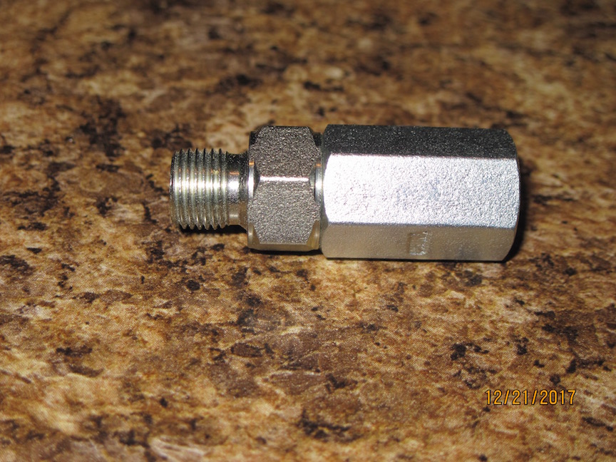

A FIX
I looked at mine, YES, Oil splashed out of the breather.
Capping it WAS NOT an option. I have had problems with plugged vents in gear boxes. So after much thought (evaluated tubes. etc) I came up with this. I have not installed it yet. My only concern is the height. The assembly shown is 1.25" H.
If it doesn't fit under the cover, I can cut it down in the lathe. Some people don't have that option, sorry.
What is nice (or better) the threaded coupler has a .140" bore, and chamfered at both ends. Once installed, I'll post pics. I do believe that this will fix the oil splashing (or pumping) out the breather
https://www.discounthydraulichose.co...ing_p/9043.htm
http://www.discounthydraulichose.com...ple_p/9000.htm
To be clear, your OEM vent is installed on top.
brettman is offline   Reply With Quote

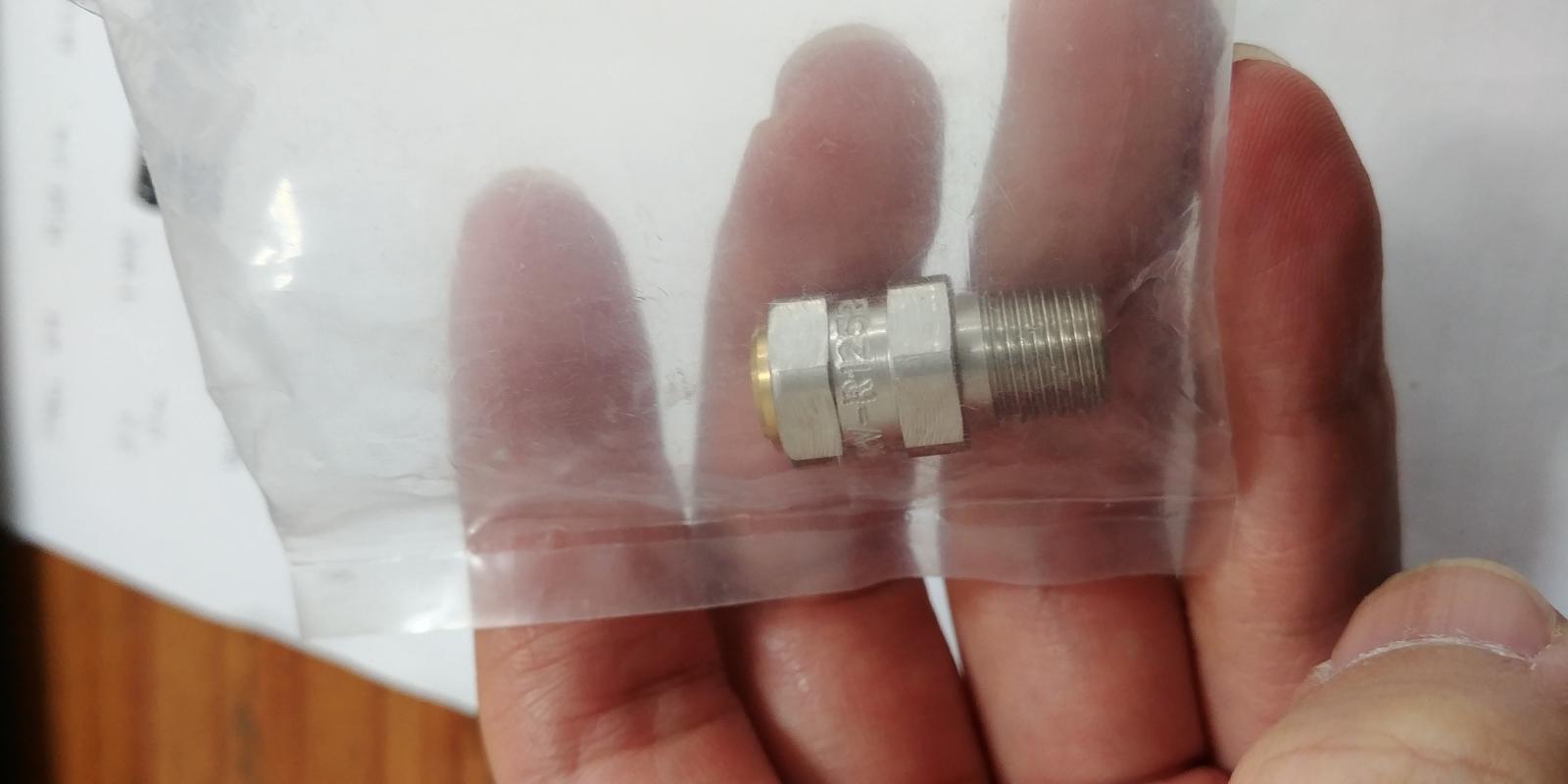

Whipple sent a new Vent valve.
they use the below
http://www.generant.com/vrv.shtml
VRV-125B(or 8)
