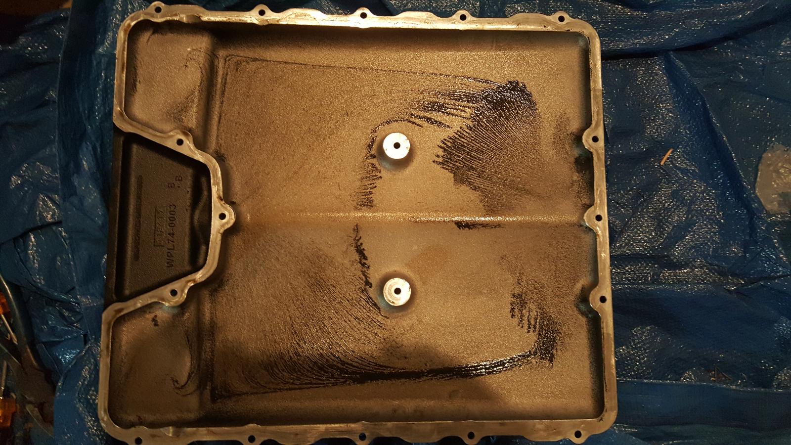

I put on 2500 miles without a catch can and as you can see, a lot of oil gets in. The good news is none made it past the intercoolers and my valves and intake ports are perfectly clean. Now I'm shopping for a catch can.

A good reminder for us PD owners. A mucked up set of intercoolers would not be a welcomed condition. Not to mention the other issues with blow by.

And we have a system designed just for the LT4 engines that addresses all of this. The intake valve coking is also happening. The splashes on the cover don't show enough. Look down into the webbing and see how much is there already:
And as you can see with this brick at 14k miles from a Maggie PD it does not take long to bake on a "varnish" that not only insulates and reduces heat transfer, but also restricts flow through over time:
Nick, let us know and we will give you a system at discount if you track and document the results. We trap 95% plus of the oil and other compounds, most other brands only come in around 15-30% max. So the right system is critical on these new GDI engines.

And empty it often. Got a little lazy and didn't check for almost 3000 miles and was nearly full. I am sure our humid summer weather played role but I was surprised how much was in there.

I installed a Whipple supercharger and the first one was bad I had to pull the heads. my Camaro only had about 1,800 miles on it at the time and I could not believe how much build-up there was already on the valves and pistons. You can look at my build thread for the pictures.
I would be interested in this as well because if there was that much build-up in my motor from just 1800 miles I can't imagine what another 10,000 would be like!!
