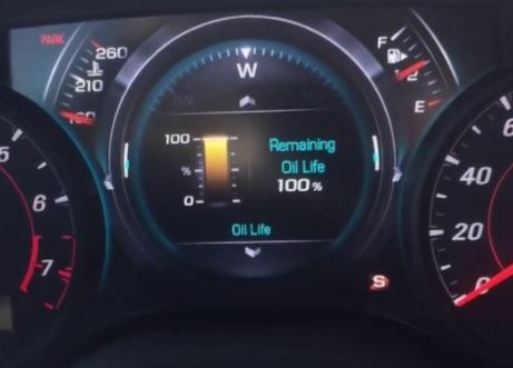

I follow this:

Originally Posted by MiamiBlueCamaro View Post
I follow this:
EXACTLY!!!
Because every driver is different, the condition and the chemical composition of the oil will be different for two cars with the exact same amount of mileage, just based on where and how you drive the car. GM's oil life sensors have been in place for over a decade and constantly measure the chemical composition of the oil. Think of it as a flex fuel monitor but for oil. If you trust the flex fuel monitor when you put E85 in your car, you should consider placing the same amount of trust in your oil life monitor.
If you have the myChevrolet app on your smartphone, it will tell you the current status of your oil at any point in time you chose to check it.
