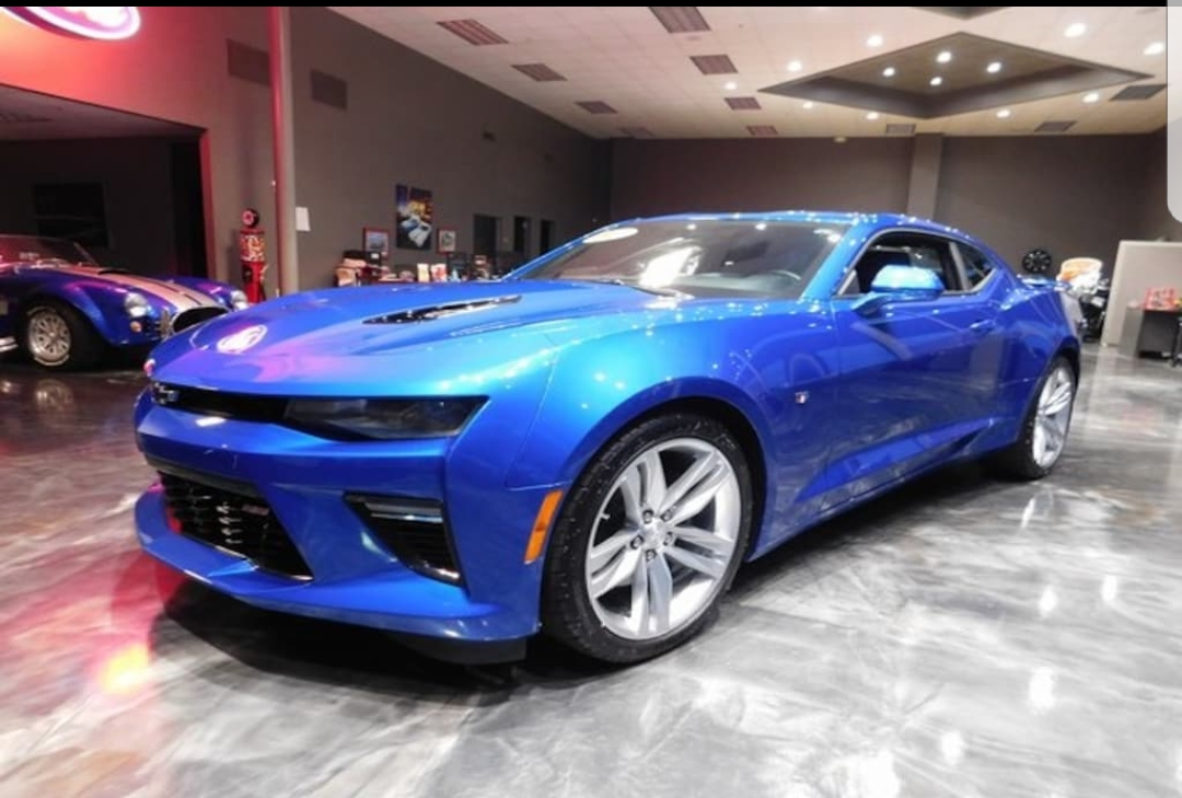

I was pretty specific on what I wanted but I finally found one. 2016 1SS A8 in Hyper Blue Mettalic. The only other option it has is a NPP exhaust.

Here's some pics of the car when I picked it up

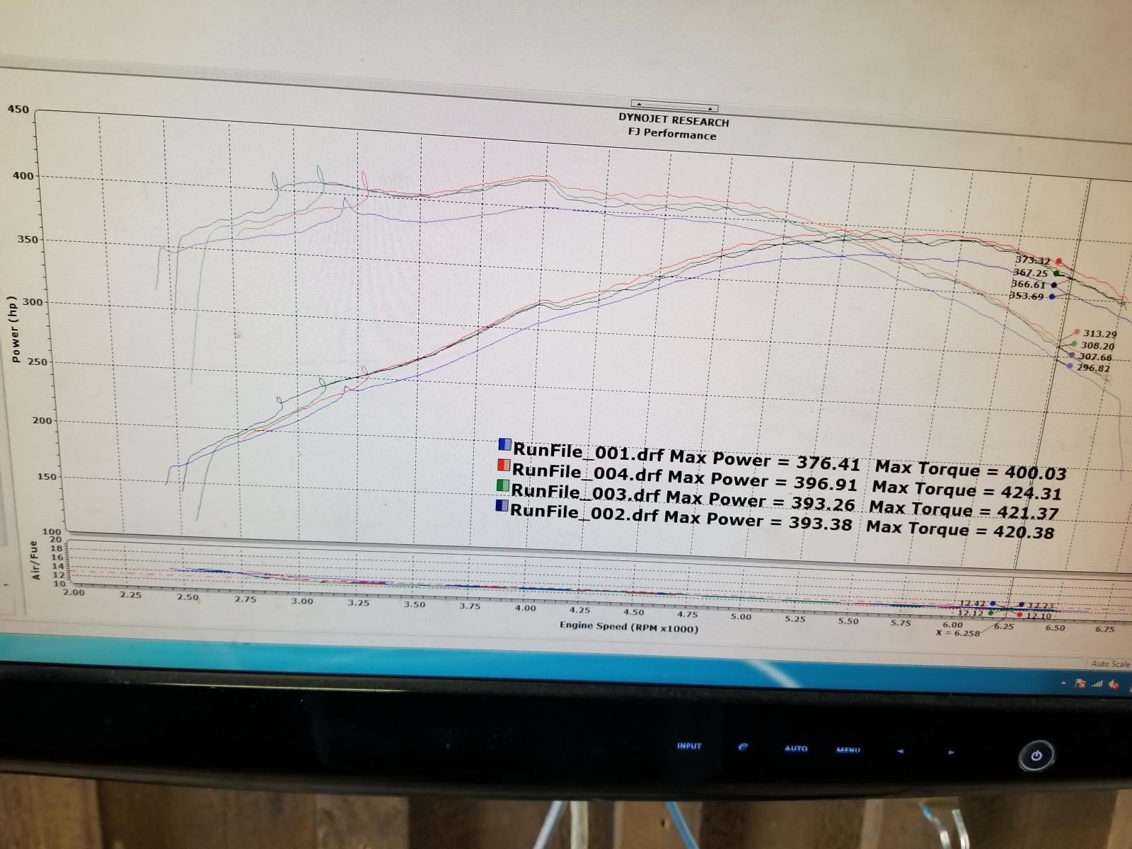

Strange baseline Dyno. We did an initial pull in 5th, because we didn't know where the speed limiter was at. After that, we went into the 1:1 gear, since that's what it is supposed to be dynoed in.... And apparently the speed limiter is at the top of 6th. Lol. GM was thinking.
Numbers were 397 rwhp 424 rwtq. Don't really care what the numbers are, but my numbers were higher than an A8 C7 that was there the week before. A/F looks like good for stock. Either way, I got something to work off of.
