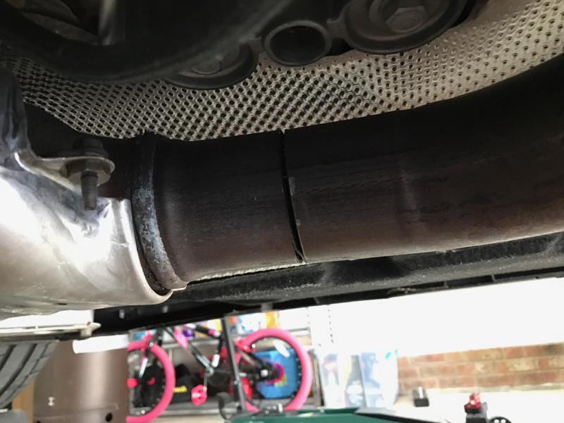

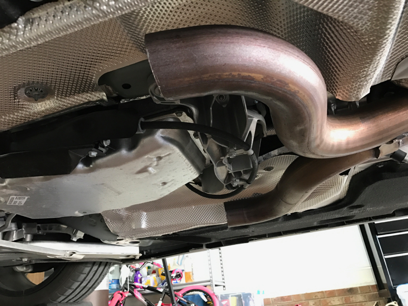

- Cut the pipes right after the secondary cats. Kooks provides the measurements.
- I rented a chain cutter from Autozone. It cut through like butter. A quick deburring with the Dremel and they are good to go.
