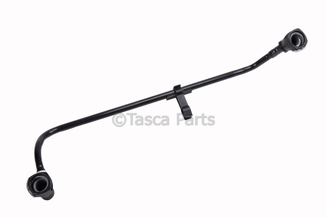

OEM PCV Valve Hose replacement
I recently broke my PCV Valve Hose. The GM dealer near me has a delay on shipment of 3-4 weeks due to Covid-19. The part itself its extremely cheap (around $9). Does anyone have an extra hose lying around or can get one to me in a few days? I am willing to pay extra for the part.

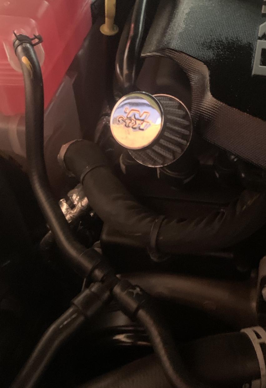

Is that the hose from dirty side PCV to air intake?
Just buy a K&N breather filter. That hose you are replacing is the dirty side PCV. GM routes it into the air intake for emission standards.
You can run with a breather filter like in the old days. It’s just like a valve cover breather cap. Just plug the hose that goes into the air intake elbow.
It's not that hose. The picture you have with the KN filter is not the hose i'm referring to. It's the hose to the right of it.

Originally Posted by Xaxas View Post
Wait, is this a thing? Will this prevent blowby from getting into the throttle body? I already have a JLT catch can on the clean side so I would like to know the benefits and disadvantages of doing this, just plug in the intake side I suppose?
Well the tuner I used Red Barn Racing” is a master mechanic as well. Formally at Cunningham's in Temecula CA and Mike advised me to run it this way. Also Lethal Garage runs it this way as others do I am sure of.
What I understand is that you will stop the blowby from the dirt side with this set up. The K&N breather filter will release blowby if something goes wrong on the dirty side like ring or piston damage. I was told that venting it into the TB was because of emission standards or something like that from the manufacturer/EPA.

What's the catch? Will it get the engine bay coated over time with blowby vapor? Do I have to cut the factory PVC hose?
If this is as brain dead and simple as it sounds I will do it, but I'd have to find plugs for the GM CAI.

That first picture is the clean side hose. The dirty side is the PCV valve line. The dirty side runs from the block to the intake manifold. That why you put a catch can on that circuit, to stop the oil vapor from getting into the intake manifold.
OP, just use a section of fuel line to join the broken hose together.
